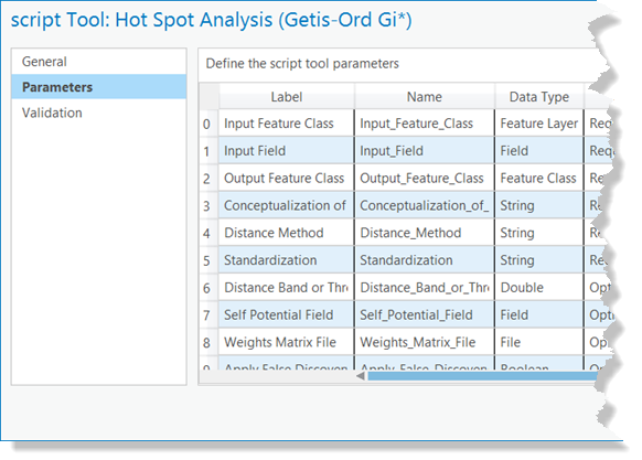

Parameter order
A tool's parameters and their order are defined on the Parameters tab of the tool's properties, as illustrated in the image below.
Parameters and their order
