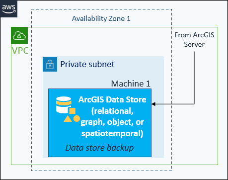

This template can create the following architecture in Amazon Web Services:
ArcGIS Data Store on one EC2 instance configured with an existing ArcGIS GIS Server site
