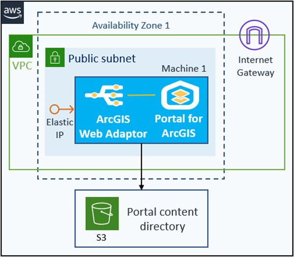

This template can create the following architecture in Amazon Web Services:
Portal for ArcGIS on one EC2 instance with content directory stored in an S3 bucket
