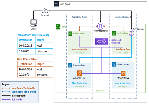

Sample architecture
The following diagram shows an example of a highly available ArcGIS Enterprise deployment in a DMZ network architecture on AWS:
Highly available base Enterprise deployment with DMZ network architecture
