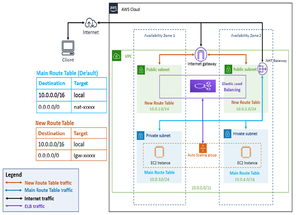

Sample architecture
The following diagram shows an example of an ArcGIS Server site in a DMZ network architecture on AWS:
Highly available ArcGIS Server site in DMZ network architecture
