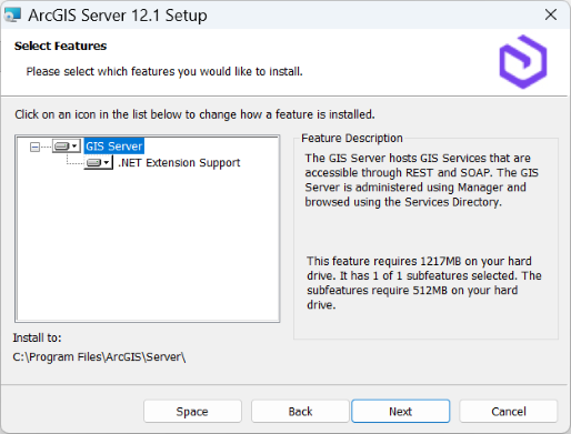

  3. Click Next after confirming the features that will be installed.
    Select features for installation.
    GIS Server—Hosts GIS services that can be accessed through REST and SOAP. It is administered using ArcGIS Server Manager and its services are browsed through the Services Directory. This feature is required, and it includes support for publishing and hosting ArcGIS Pro-based services.
    .NET Extension Support—Supports the development and deployment of .NET server object extensions (SOEs) and server object interceptors (SOIs). This feature is optional. The appropriate version of Microsoft .NET is required for the .NET Extension Support feature to be displayed as a feature to be installed.
    See the ArcGIS Server system requirements for the currently supported version of Microsoft .NET.
