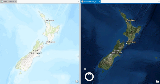

    The project opens with a 2D map and a 3D scene. Both are zoomed to New Zealand.
    A map and a 3D scene centered on New Zealand

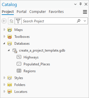

  9. In the Catalog pane, on the Project tab, expand the Databases container and expand create_a_project_template.gdb.
    Contents of the default geodatabase in the Catalog pane
    The default geodatabase contains three feature classes: Highways, Populated_Places, and Regions. These datasets will also be included in the project template.

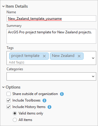

  3. Under Item Details, in the Name box, replace the default name with New_Zealand_template. Add your name or initials to the name.
    This makes your template recognizable if other people in your organization create a project template with the same name.
  4. In the Summary box, type ArcGIS Pro project template for New Zealand projects.
  5. In the Tags box, type the following keywords: project template, New Zealand. (Be sure the two tags are separated by a comma.) Press Enter.
    Item details for the project template
    Note:
    If spell-checking is enabled on the settings page (as it is by default), unrecognized words will be marked with wavy underlines. See Set proofing options for more information.
  6. Accept the default settings for the Share outside of organization, Include Toolboxes, and Include History Items options.
    The Share outside of organization option is used when the template will be shared with people who don't have access to resources, such as network drives, that are paths to datasets used in the template. It removes these connections and copies the datasets into the template. The option is described in more detail in Share a project package.

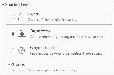

  8. Under Sharing Level, click Organization.
    Sharing options for the project template
    All members of your organization will have access to this template.

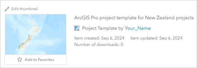

    The item details page for the project template appears. It includes a thumbnail image and summary information. The Description and Terms of Use sections need to be filled in.
    Thumbnail image and summary information for project template

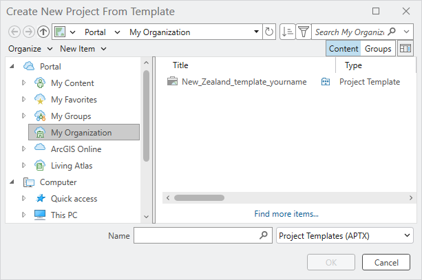

  3. On the Create New Project From Template browse dialog box, in the navigation pane, click My Organization .
    Browse dialog box showing the project template
    The template appears at the top of the content list.
  4. Click New_Zealand_template_yourname and click OK.
