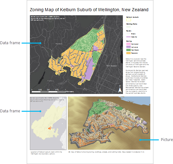

The ArcMap map package you'll import contains a map document with two data frames and a layout. One data frame displays zoning in the Kelburn suburb of Wellington. The other data frame shows the suburb in relation to the rest of the city.
Both data frames appear on the layout, which also contains a legend, a picture, and other map elements.

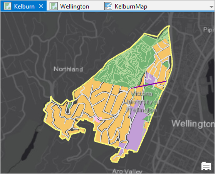

    Map view of Kelburn suburb
    A map view named Kelburn opens. This map corresponds to one of the two data frames in the ArcMap map document. Layers representing the suburb boundary, walking paths, roads, and zoning are displayed on a dark gray basemap. You'll use the Catalog pane to see other items that were imported with the map document.
    A Transformation Warning notification appears because the basemap and reference layers in the map have a different geographic coordinate system from the other layers. The warning is not a concern in this tutorial.

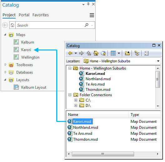

  6. In the Catalog pane, on the Project tab, expand the Maps container .
    Catalog pane

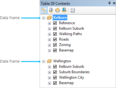

    The project contains two maps: the open Kelburn map and a map named Wellington. The Wellington map corresponds to the second data frame in the ArcMap document. Each data frame in an ArcMap document becomes a separate map in ArcGIS Pro.
    The following image shows the two data frames as they appear in the ArcMap table of contents.

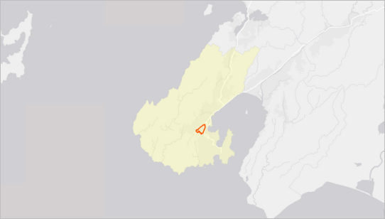

    Overview map of Wellington
    The city limits of Wellington are shown in light yellow. The suburb of Kelburn is marked with a red outline.

    The layout in an ArcMap document becomes a layout item in ArcGIS Pro. The name of the layout, KelburnMap, matches the name of the imported ArcMap document.
  9. Under Layouts, right-click KelburnMap and click Open .
    The layout looks like the image of the ArcMap layout at the beginning of this section.

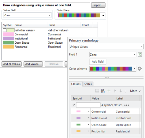

  2. In the Contents pane, click the Zoning layer to select it.
  3. On the ribbon, click the Feature Layer tab. In the Drawing group, click Symbology . (Click the button, not the drop-down arrow.)
    The Symbology pane appears. The Zoning layer is symbolized by unique values in the Zone field of the layer attribute table, just as it is in ArcMap.
    Symbology settings in ArcMap and ArcGIS Pro
    Symbology properties of the Zoning layer are shown in ArcMap (top) and ArcGIS Pro (bottom).
    ArcGIS Pro and ArcMap use different methods to construct symbols, but the appearance of imported symbols is usually the same. For more information about how symbols are modeled in ArcGIS Pro, see Symbols.
    Note:
    The symbol colors for the Zoning layer have identical RGB values in ArcMap and ArcGIS Pro. However, symbol colors may not match exactly when you import algorithmic color ramps or when colors are defined with color models other than RGB. See Visual differences in imported map documents.
    You have confirmed that symbology properties are maintained in the imported map.

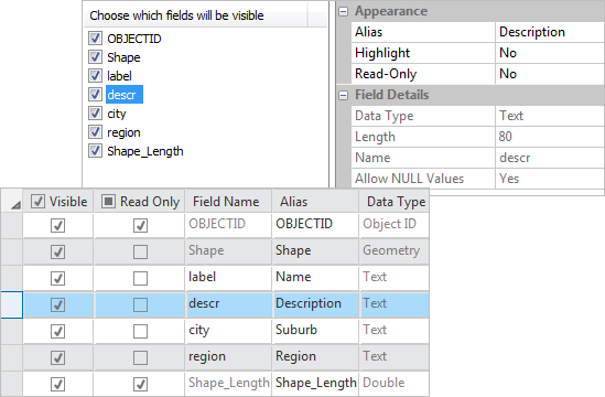

  4. In the Contents pane, right-click the Roads layer and click Data Design > Fields .
    The fields view of the Roads attribute table opens. The fields view is used to display and edit field properties. The following image shows that field names, aliases, data types, and other properties have been imported with no changes.
    Field properties in ArcMap and ArcGIS Pro
    Properties of the descr field in the Roads layer are shown in ArcMap (top) and ArcGIS Pro (bottom). In both cases, the field name is descr, the alias is Description, and the data type is Text.

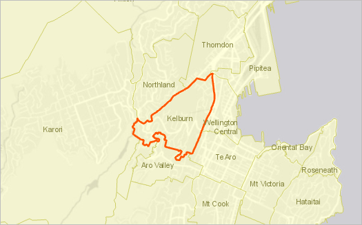

  7. On the ribbon, on the Map tab, click Bookmarks . Under Wellington Bookmarks, click Suburbs.
    Map of Wellington zoomed to the suburb of Kelburn
    When the map zooms in, the names and boundaries of Wellington suburbs are displayed. (The bookmarks were also imported from the ArcMap document.)

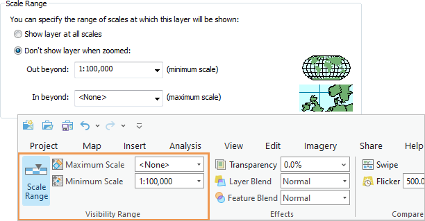

    In the Visibility Range group, note that the Minimum Scale setting is 1:100,000. This matches the layer's Scale Range setting in ArcMap.
    Scale range settings in ArcMap and ArcGIS Pro
    Top: Scale range settings are shown for the Suburb Boundaries layer in the ArcMap layer properties. Bottom: Visibility range settings are shown on the ArcGIS Pro ribbon.

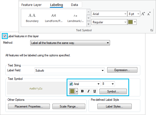

  10. On the ribbon, click the Labeling tab.
    In the Layer group, the Label button is selected. This confirms that labeling is turned on for the layer. Clicking the button turns the labels on and off.
    The Text Symbol group shows the label symbol properties. The font is Arial 8 point Regular and the color is Lichen Green (its RGB value is 137, 137, 68). These settings match the ArcMap layer property settings.
    Label settings in ArcGIS Pro and ArcMap
    Top: Label properties are shown for the Suburb Boundaries layer on the ArcGIS Pro ribbon. Bottom: The equivalent settings are shown in ArcMap.

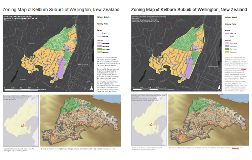

A quick visual comparison of the ArcMap and ArcGIS Pro layouts shows that they are nearly identical. You'll take a closer look at some of the layout elements.
Side-by-side view of the ArcMap and ArcGIS Pro map layouts
The first image shows the ArcMap layout and the second image shows the ArcGIS Pro layout.

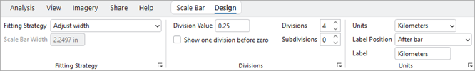

  3. On the ribbon, click the Design tab.
    Scale and unit settings such as the division value, number of divisions, and units have been imported correctly from ArcMap.
    Scale bar properties on the Design tab of the ribbon
    The Design tab settings on the ArcGIS Pro ribbon match the Scale and Units tab of the Alternating Scale Bar Properties dialog box in ArcMap (not shown).

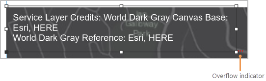

  8. Hover over the lower middle selection handle of the text element. When the mouse pointer changes to a double-headed arrow, drag downward slightly.
    The complete list of credits is displayed for the World Light Gray Canvas Base and the overflow indicator disappears.

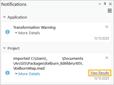

    At the top of the ArcGIS Pro window, the Notifications indicator has a blue dot. This means there are notifications to look at.
  14. Click the Notifications indicator .
    The Notifications pane appears with two notifications: one is the transformation warning you saw earlier and the other is about the import process.
  15. In the Notifications pane, under Project, hover over the second notification and click View Results.
    Message with View Results link in Notifications pane
    When you hover over the message, the View Results link appears.
    A browser tab (pointing to a local file) opens with import results. There are three warnings that basemap layers cannot be published directly to a service. The warning appears three times because the Wellington map has a basemap and the Kelburn map has a basemap and a reference layer. Although the warnings have high severity, they are only important if you share the map.
    Three other warnings describe possible problems with the imported layout. These are generic warnings and don't necessarily imply problems with this layout. However, the warning about dynamic text tags may explain the overflow indicators on your text elements because service layer credits are dynamic text.
  16. Close the browser tab with the import results.
  17. In the Notifications pane, click Menu and click Dismiss all.

    You can also import a map document by dragging it from ArcCatalog or the Catalog window in ArcMap to the Catalog pane in ArcGIS Pro. Select multiple map documents to import them in one operation.
    Map document dragged from the Catalog window in ArcMap to the Catalog pane in ArcGIS Pro
    Multiple map documents can be imported to a single ArcGIS Pro project.

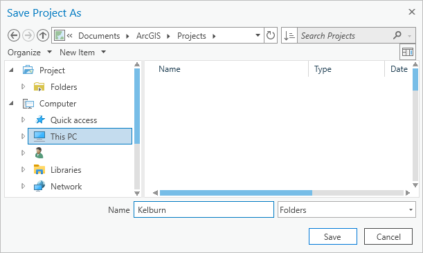

  1. On the Quick Access Toolbar, click Save Project .
    The Save Project As browse dialog box appears. This dialog box initially defaults to C:\Users\<user>\Documents but opens to its last used location, so your location may be different.
    Tip:
    You can also set a custom location for saving projects in the General options. You can also change the default behavior of browse dialog boxes in the catalog browsing options.
  2. Optionally, browse to a different location to save the project.
  3. In the Name box, type Kelburn.
    Save Project As dialog box
