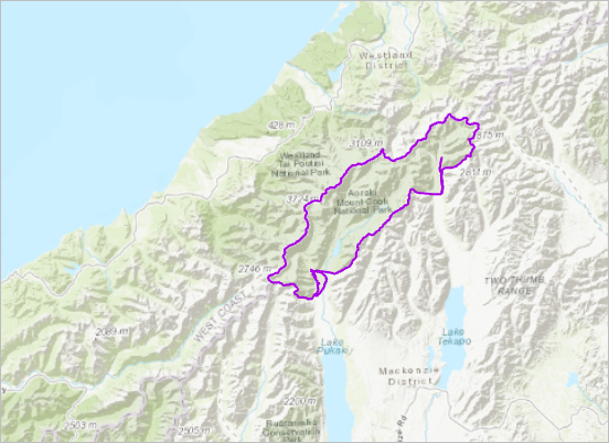

  7. In the Contents pane, turn on the Aoraki/Mount Cook National Park layer to see the park boundary.
    Map of Aoraki/Mount Cook National Park

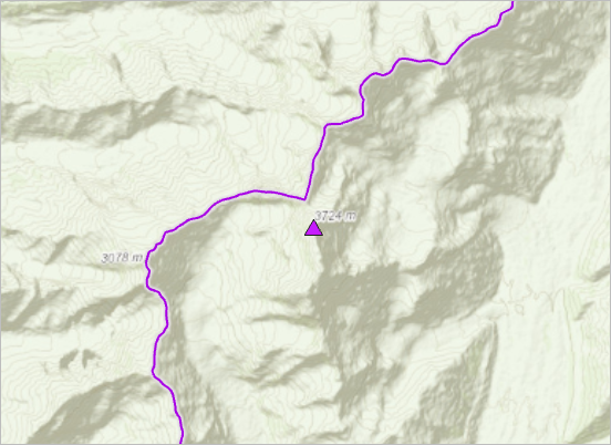

  7. In the Contents pane, turn on the Aoraki/Mount Cook layer.
    The peak is symbolized with a purple triangle.
  8. Press and hold the Ctrl key and click the peak to center it in the view.
  9. On the status bar, click the map scale drop-down arrow and click 1:100,000.
    Map showing Aoraki/Mount Cook

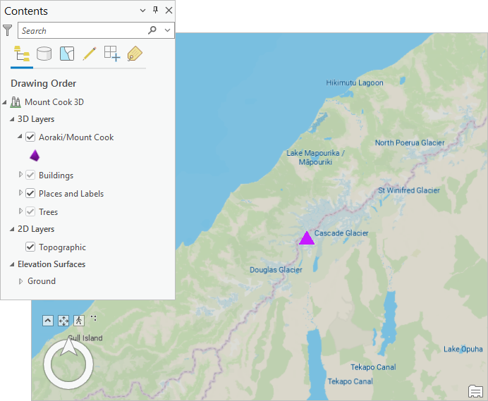

  3. In the Contents pane, under 3D Layers, turn on the Aoraki/Mount Cook layer.
    The purple symbol for the mountain displays in the center of the view.

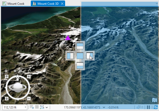

  1. Drag the active Mount Cook 3D view tab and drop it on the right-hand docking target that appears.
    Mouse pointer hovering over docking target
    When the view is docked in its new position, the map and scene display side by side.
    Map and scene displayed side by side

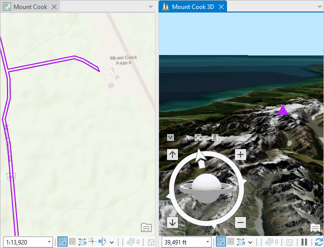

  2. On the ribbon, click the View tab. In the Link group, click the Link Views drop-down arrow and click Center and Scale .
    The map zooms to an extent and scale that match the scene. The view tabs for the map and scene are marked with icons to show that they are linked.
  3. Navigate the scene using the Explore tool or the on-screen navigator .
    The map and scene pan, zoom, and rotate together.

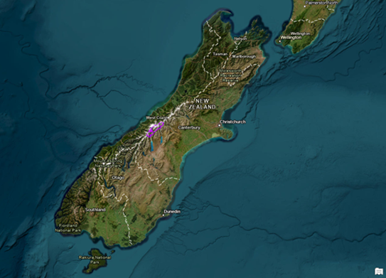

  7. Press the Hyphen (-) key repeatedly to zoom out to the South Island.
    Scene zoomed to the South Island
  8. Press the Equals (=) key to zoom back in.
    Tip:
    Press and hold either key to zoom continuously.

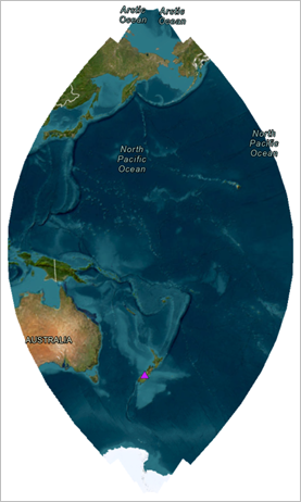

  9. Press the Insert key to zoom to the full extent.
    View of the map zoomed to full extent
    The scene's coordinate system, NZGD 2000 New Zealand Transverse Mercator, limits the map extent.

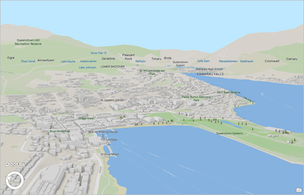

  12. Use the keyboard shortcuts in the following table to explore Queenstown. Press and hold a key to apply its effect continuously.
    Keyboard shortcut Effect
    Arrow keys Pan
    Equals (=) Zoom in
    Hyphen (-) Zoom out
    A Rotate the camera counterclockwise
    D Rotate the camera clockwise
    W Tilt the camera up
    S Tilt the camera down
    U Raise the camera
    J Lower the camera
    N Look north
    P Look down
    Keyboard shortcuts for navigation
    View of Queenstown
