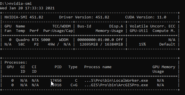

How do you monitor how much GPU memory is being used?
Use nvidia-smi, which is a command line utility that is installed with NVIDIA drivers.
Open a Windows Command Prompt window.
Type nvidia-smi.
Press the Enter key.
Note:
If
nvidia-smiis not found, you need to change to the proper directory in the Command Prompt window before you run the command. Use the Windows search bar to locatenvidia-smi.
Under GPU Memory Usage, you can determine whether GPU memory is being used.
To monitor the continuous usage of your GPU when running the tools, you can run nvidia-smi -l 10. You can use this to determine what the batch size should be when running the deep learning tools. If you notice there is memory not being used, you can increase the batch size. If you notice that the memory usage is at its maximum and the tool fails, decreasing the batch size should help.
