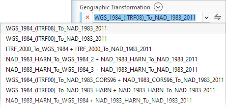

The Geographic Transformation parameter on several tools may specify a default transformation path based on the input and output data’s coordinate systems by default, but you can specify a different one. The list of available transformations include system-provided transformations and custom transformations created using the Create Custom Geographic Transformation or Create Custom Vertical Transformation tools.
To specify a transformation, type in a transformation name or select an option from the choice list.
The Geographic Transformation parameter on the Project tool

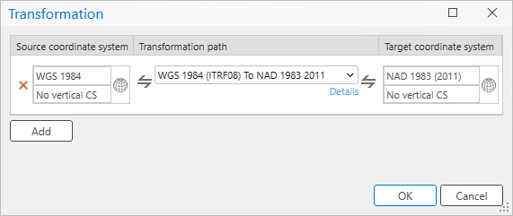

Alternatively, click the Select transformation button to open the Transformation window. In the window, specify a Source coordinate system and Target coordinate system, and select a Transformation path option. The Source coordinate system and Target coordinate system may autofill with the geographic coordinate system of the input dataset and output coordinate system.

Specify multiple transformations using the following steps:
  1. Click the Select Transformation button to open the Transformation window.
  2. Click the Add button to add an additional transformation.
  3. Specify the source and target coordinate system by clicking the Set Coordinate System buttons to choose geographic and vertical coordinate system pairs.
    The source and target coordinate systems must be in the geographic coordinate systems that represent the datums between which a transformation will be applied.
  4. Use the Transformation Path drop-down list to select the transformation used to convert between the source and target coordinate system. Click the Details button to see more information about the transformation path.
  5. Click the Add button to add another transformation or click the OK button to save and close the window.
