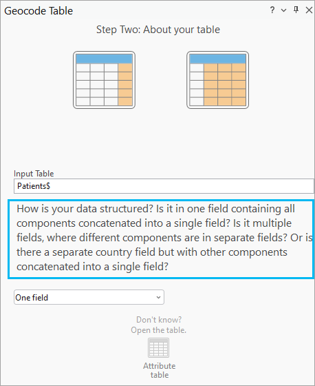

  7. For the question starting with How is your data structured?, select One field from the drop-down list.
    Geocode data from one field

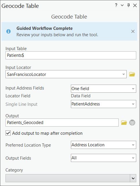

  10. For the Output field name, ensure that it lists Patients_Geocoded as the new feature class name.
  11. Click Next.
  12. Do not update anything in the Limit by Category step. Click Finish.
  13. Review the inputs in the Geocode Table geoprocessing tool and click the Run button at the bottom of the pane.
    Geocode Table geoprocessing tool with inputs

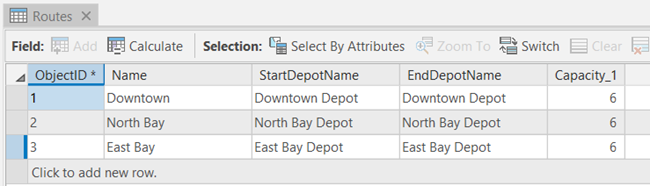

The logistics company has three vans, each with a maximum capacity of six passengers. The vans start and return to the depots after completing all the trips. One of the vans that operates within the downtown area has a lift to provide easy access for wheelchairs.
You will add three routes, one for each van. In this section, you will add the routes using the Routes attribute table. Other options are to use the Add Locations tool to import a table that you have already created or to use the Add Fleet Routing Routes geoprocessing tool, which will create a set of routes with the same parameters. In this case, you have enough settings per route that the quickest method will be to enter the values directly in the table.
  1. In the Contents pane, right-click Routes and select Attribute Table from the context menu.
    The attribute table appears with the input and output fields for each route.
  2. Click the Click to add new row button to add information for the three routes as below:
    Name
    StartDepotName
    EndDepotName
    Capacity_1
    Downtown
    Downtown Depot
    Downtown Depot
    6
    North Bay
    North Bay Depot
    North Bay Depot
    6
    East Bay
    East Bay Depot
    East Bay Depot
    6
    Three routes added to the Routes attribute table

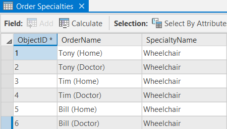

First, you will enter the order specialties information.
  1. In the Contents pane, right-click Order Specialties and select Open from the context menu.
    The attribute table appears, and you can enter the information about each order with a specialty.
  2. Click the Click to add new row button to add information, as shown below:
    OrderName
    SpecialtyName
    Tony (Home)
    Wheelchair
    Tony (Doctor)
    Wheelchair
    Tim (Home)
    Wheelchair
    Tim (Doctor)
    Wheelchair
    Bill (Home)
    Wheelchair
    Bill (Doctor)
    Wheelchair
    Order and specialty added to the Order Specialties attribute table
  3. Click the Edit tab, and in the Manage Edits group, click the Save button .
  4. Click Yes on the Save Edits dialog box.
  5. Close the Order Specialties attribute table.

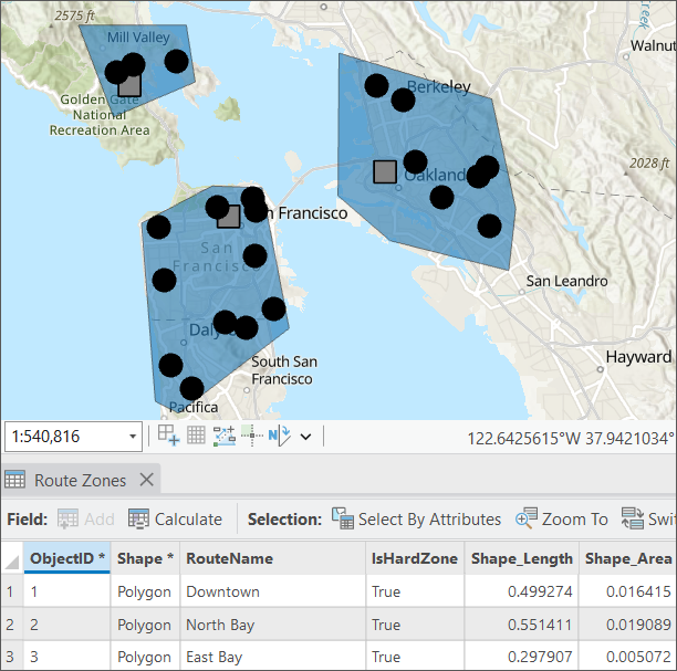

Add route zones
The three vans used by the company are only licensed to service orders in a predetermined area. You will add route zones and associate them with the vans or routes.
In this section, you will draw the boundaries of these zones using the Create Features pane; however, if you have zones already digitized, they can be imported using the Add Locations geoprocessing tool.
  1. On the VRP Layer tab, in the Input Data group, click Create Features .
    The Create Features pane appears, showing the templates for the feature classes associated with the selected VRP layer.
  2. In the Create Features pane, select Vehicle Routing Problem : Route Zones.
  3. On the map display, digitize a polygon that roughly covers the downtown area, as shown below.
    Route zone created for the downtown area
  4. In the Contents pane, right-click Route Zones and select Attribute Table from the context menu.
    The attribute table appears, and you can enter the information about the route zone you just created.
  5. Double-click in the first row under RouteName to edit the value and type Downtown.
    This is the name of the route associated with this route zone.
  6. Ensure that the IsHardZone value is set to True.
    The van can't service orders that are outside the route zone. Setting this value to True ensures that the van is only assigned orders that are within the route zone.
  7. Repeat steps 3 through 6 to add two more route zones: one for the North Bay and the other for the East Bay.
    Route zone created for East Bay and North Bay
  8. Click the Edit tab, and in the Manage Edits group, click the Save button .
  9. Click Yes on the Save Edits dialog box.
  10. Close the Route Zones attribute table.

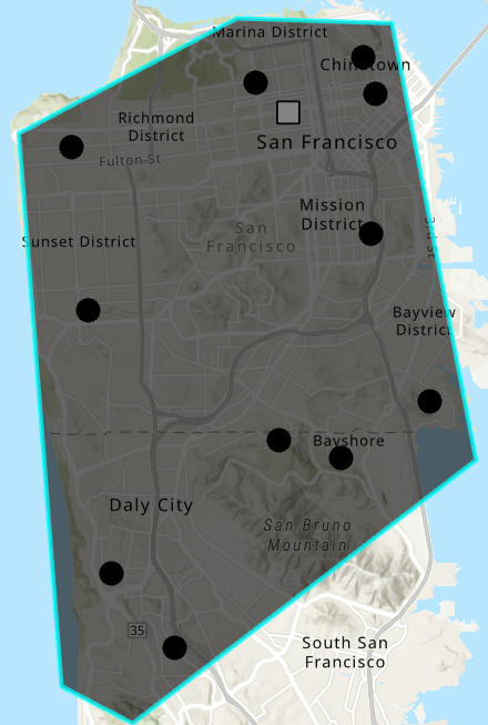

Run the analysis
Run the VRP analysis to determine the best route assignment.
  1. On the VRP Layer tab, click Run .

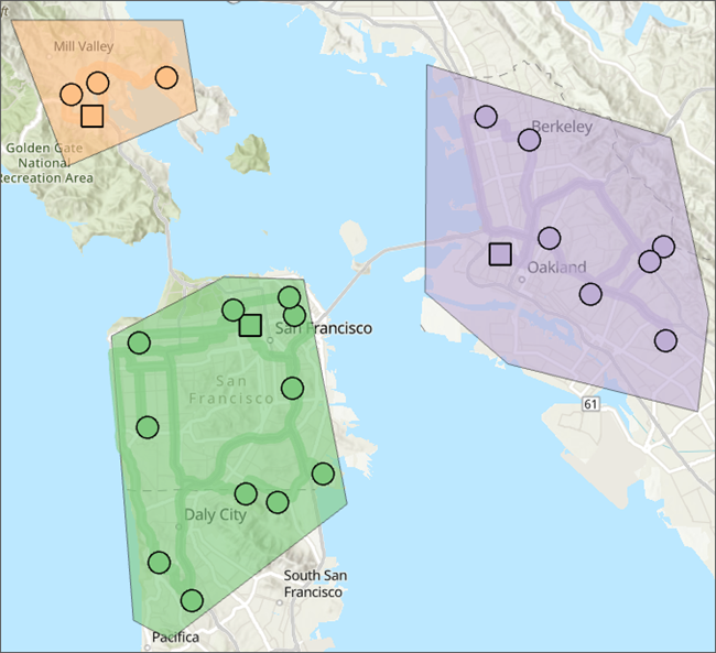

    The VRP solver calculates the routes for each van. Each route begins at a depot, the van picks up one or more people if the time they spend on the van is less than the MaxTransitTime specified in the order pair, drops them at their hospital locations, continues to pick up and drop off other people, and returns to the depot at the end. The routes only service orders in their assigned route zones.
    VRP solution with three routes servicing a set of orders with specialties
Open the Orders attribute table and see when the patients will be picked up and dropped off by looking at the ArriveTime field. Additionally, you can get the information about how long each route will take by looking at the TotalTime field in the attribute table of the Routes sublayer.
Note:
In the TimeWindowStart and TimeWindowEnd fields, 12/30/1899 is interpreted as today. See Dates and times for more information.
