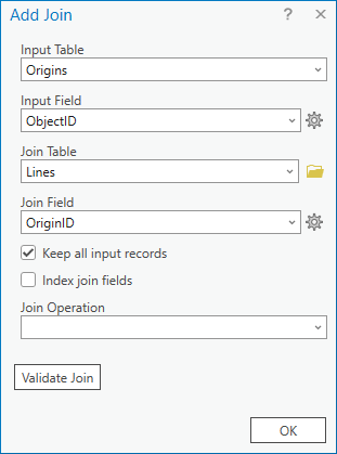

First, join the data from the Lines sublayer to the Origins sublayer to associate the calculated driving time with each origin.
  1. Right-click the OD Cost Matrix:Origins sublayer and click Joins and Relates > Add Join.
    The Add Join tool appears.
  2. Verify that the Input Table parameter is set to Origins.
  3. Set the Input Field parameter to ObjectID.
  4. Set the Join Table parameter to OD Cost Matrix\Lines.
  5. Set the Join Field parameter to OriginID.
    The OriginID field in the Lines sublayer corresponds to the ObjectID field in the Origins sublayer. Consequently, it can be used for joins.
    Add Join tool dialog box
  6. Leave the default settings for the rest of the parameters and click the OK button.
    The data from the Lines sublayer is joined to the Origins sublayer.

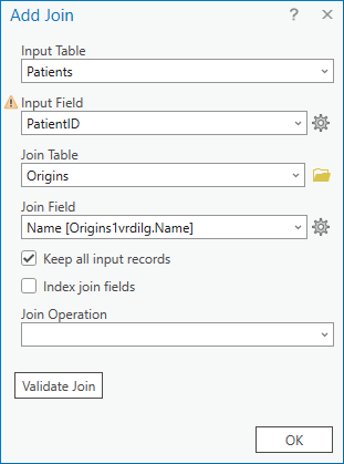

    Next, join the data from the Origins sublayer to the Patients layer that was used as input for the OD cost matrix analysis. This allows you to transfer the calculated driving times and identify patients that couldn't reach a hospital within the driving time cutoff.
  10. Right-click the Patients layer and click Joins and Relates > Add Join.
  11. Verify that the Input Table parameter is set to Patients.
  12. Set the Input Field parameter to PatientID.
  13. Set the Join Table parameter to OD Cost Matrix\Origins.
  14. Set the Join Field parameter to Name.
    Caution:
    The joined Origins table includes two fields called Name. One is from the Origins sublayer, and the other is a joined field from the Lines sublayer. Use the Name field from the Origins sublayer. The list of fields in the Join Field parameter may include some additional text next to the field name indicating which table it comes from. That text is the automatically generated feature class name for the Origins sublayer, which is typically the text Origins followed by some random characters.
    Because you mapped the PatientID field to the Origins sublayer's Name field earlier, the values can be used for joins.
  15. Leave the default settings for the rest of the parameters and click the OK button.
    The data from the OD cost matrix is joined to the Patients layer.

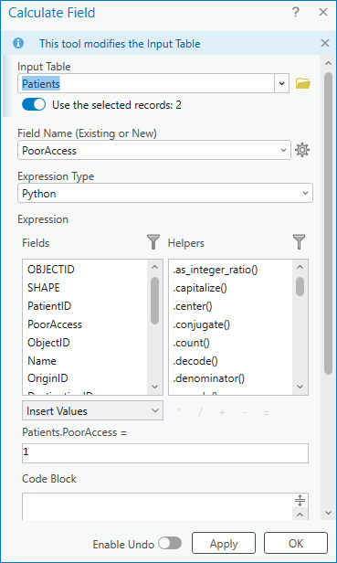

  22. In the attribute table for Patients, find the PoorAccess field.
  23. Right-click the PoorAccess field header and click Calculate Field.
    The Calculate Field tool opens.
  24. Verify that the Input Table parameter is set to Patients and the Field Name parameter is set to PoorAccess.
  25. Configure the Expression parameter to calculate the PoorAccess field to a value of 1 by setting the text box labeled Patients.PoorAccess = to 1.
    Calculate Field dialog box
  26. Leave the default settings for the rest of the parameters and click the OK button.
    The PoorAccess field is set to 1 for the selected rows.
