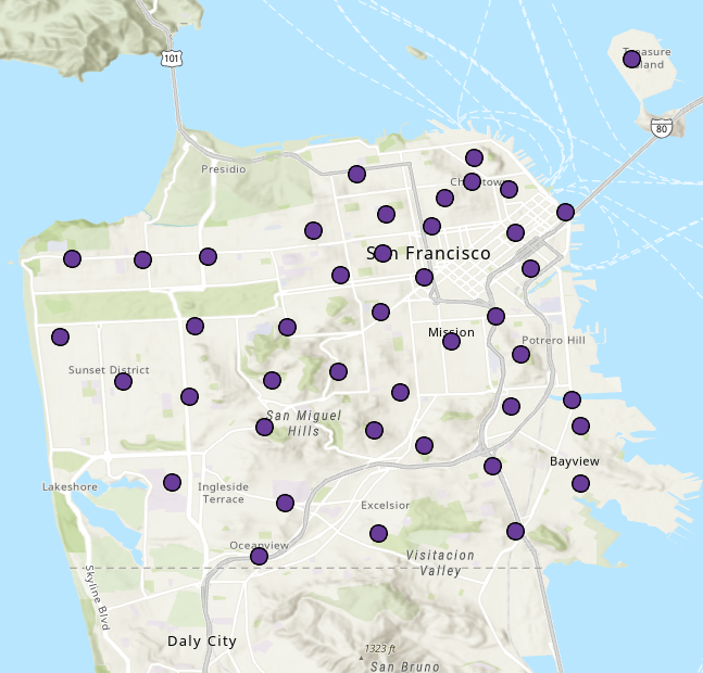

The fire stations load as facilities.
Fire stations loaded as facilities

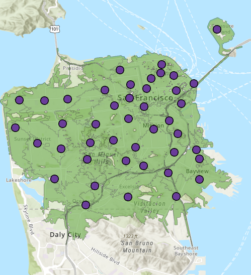

  1. On the Service Area Layer tab, in the Analysis group, click Run .
    The results show the areas that can be reached in a four-minute drive from each fire station. Any area not covered by a polygon cannot be reached within four minutes.
    Areas that can be reached in a four-minute drive from each fire station

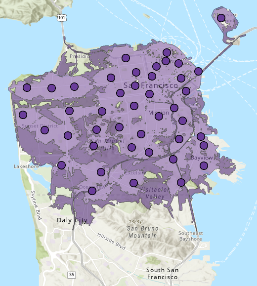

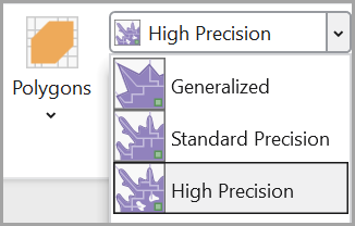

  2. The polygon precision is set to its standard level for generating quick and fairly precise results. In the Output Geometry group, change the polygon detail level from Standard Precision to High Precision.
    High precision polygon detail
  3. On the Service Area tab, click Run .
    The list of results is the same, but the polygons more accurately represent response times.
    Polygons representing response times more accurately

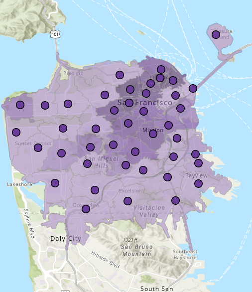

Generate non-overlapping polygons
The response-time polygons overlap one another in many parts of the city. This indicates that more than one fire station can reach those areas within four minutes. This is valuable information, but now you'll change the analysis settings so that polygons don't overlap one another. You'll see which fire station has the quickest response time to each area of town that's within four minutes of a fire station.
  1. On the Service Area Layer tab, in the Output Geometry group, change the Boundary Type from Overlap to Split.
  2. On the Service Area Layer tab, click Run .
    The updated polygons don't overlap. Polygon boundaries meet where response times to different fire stations are equal. Although a street may be within four minutes of more than one fire station, it's covered by one polygon only, that is, the polygon associated with the nearest fire station.
    Non-overlapping polygons showing fire stations that can reach an area within four minutes

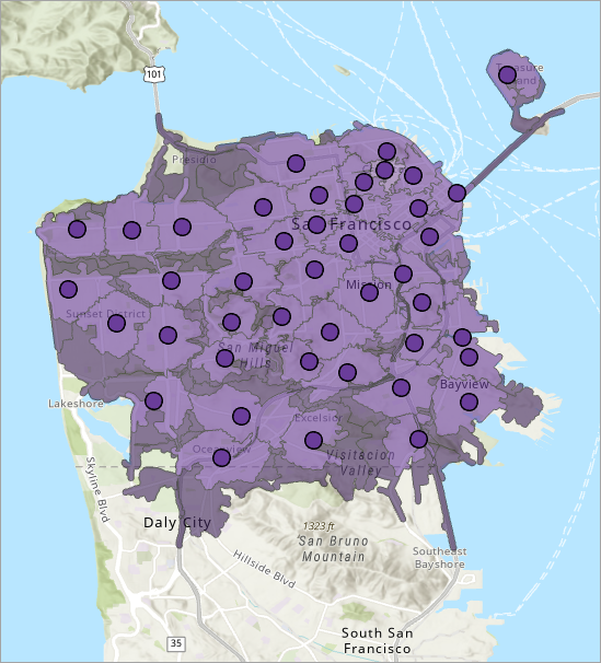

  1. In the Travel Settings group, type 2, 4 in the Cutoffs text box.
    Each polygon shows the streets that fire trucks from a particular fire station can reach within two- and four-minute response times.
    Reachable areas within two or four minutes of a particular fire station

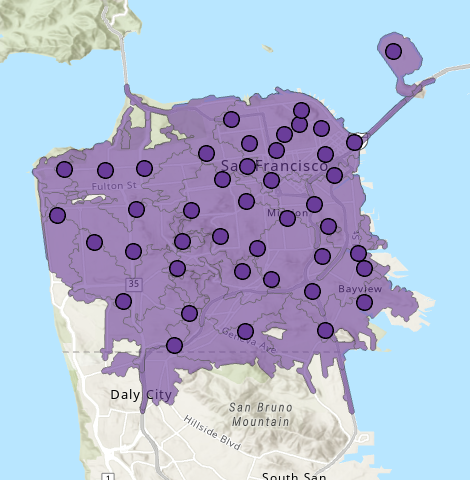

  3. In the Output Geometry group, change the Output Facility Allocate Type drop-down menu from Split to Dissolve.
  4. On the Service Area Layer tab, click Run .
    The map shows areas of town covered within the two response times—without specifying which fire station covers the area. This map more clearly shows what areas are within two or four minutes of any fire station.
    Reachable areas within two or four minutes of any fire station
