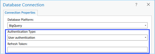

  5. If you choose User authentication, provide a refresh token.
    User authentication to connect to BigQuery

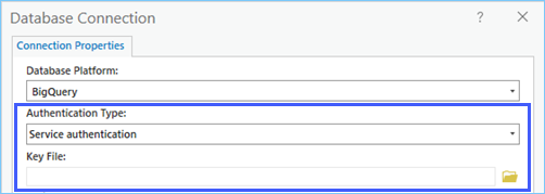

  6. If you choose Service authentication, browse to the location of the key file that contains the credentials you need to connect to BigQuery, select the file, and click Open.
