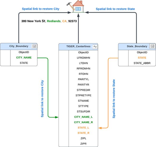

The diagram below shows how the roles used to build the locator described above are connected to the TIGER data and the minimal fields that should be mapped for each role. The City_Boundary layer is used as the reference data for the City role, and the value from the CITY_NAME field is restored in the geocode result when searching for a street address. The State_Boundary layer is used as the reference data for the State role and the value from the STATE field are restored in the geocode result when searching for a street address.
Diagram of data to build a locator that restores zones using spatial linking
