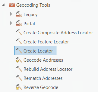

  2. Select the Create Locator tool.
    1. In the Geoprocessing pane, click the Toolboxes tab.
    2. Click Geocoding Tools in the list of geoprocessing toolboxes.
    3. Click the Create Locator tool in the list of geocoding tools.
      Create Locator tool

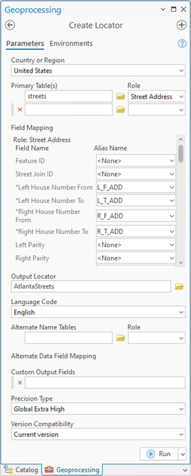

  3. In the Create Locator tool pane, click the Role drop-down list and choose the role on which you want to base the locator.
    For more information about the right role for your data, see Primary locator roles.
  4. Click the Browse button next to the Primary Table(s) text box.
    The Primary Table(s) dialog box appears.
  5. Browse to the primary reference data you want to use in the locator and click OK.
    If you have more than one dataset that you want to use in the locator, you can repeat this step until all of the primary reference data you want to include in the locator is reflected in the tool. However, only one primary table can be used per role when building a locator with this tool.

  6. Click the drop-down arrow in the Alias Name column and choose the proper field name to map fields in your data to fields expected by the specified locator role.
    An output file name and destination are automatically selected.

  7. To change the file name and destination values, click the Browse button next to the Output Locator text box.
    The Output Locator dialog box appears.
  8. Specify where to store the locator (the save location must be in a file folder), name it, and click Save.

  10. Click Run .
