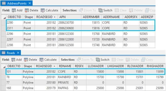

PointAddress and street reference data

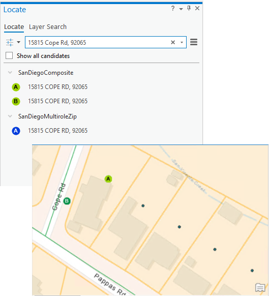

For example, using the data above, a composite locator is created with two individual locators based on the Point Address and Street Address roles named SanDiegoComposite. A multirole locator based on the Point Address and Street Address roles is created for both roles named SanDiegoMultiroleZip. The result of searching for 15815 Cope Rd, 92065 in the Locate pane is shown below.
Results of composite and multirole locators

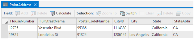

When you create a multirole locator, you can restore missing attributes between reference data layers and roles for features that have the same ID. This functionality occurs when a corresponding field value is missing in the reference data for a specific ID in one role but exists for the same ID in the reference data of a different role. This assumes that the same value of the same ID is assigned to the same feature throughout the reference data. In the data below that is used for the Point Address role, the city name is missing for Yosemite Blvd, so the locator does not return a match or include the city name in the output for this record.
PointAddress data with CityID field containing ID to join to City data

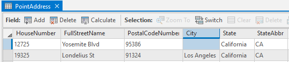

For example, if you are building a locator based on the Point Address role using the reference data below, the record for Yosemite Blvd is missing the city value again. However, this time there is no CityID field that contains the ID to link the data together, which is described in the previous section.
PointAddress data without Join ID field and missing city name value
However, if the City role that references polygon features is added to the locator, the city values can be restored for the Point Address role spatially.
