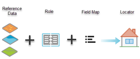

One of the first processes in geocoding with your own data is creating a locator. Creating a locator involves selecting reference data—such as street centerlines, tax parcels, or building name layers—determining the correct locator role for the reference data, and mapping the appropriate data fields to the fields from the selected locator role or roles. You can create a single locator using multiple reference datasets and roles, which can be used to search for multiple types of locations at once.

The key components for building a locator are described in the sections below.
