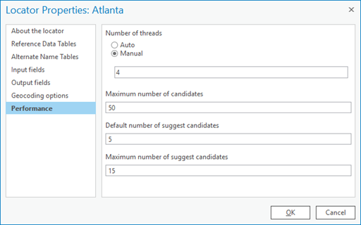

Performance tab
Number of threads
It is recommended that you determine the number of physical cores that you can devote to a geocoding job available on the machine you will be using for geocoding. Geocoding can use all of the physical cores on your machine to complete a geocoding job more quickly. By default, this value is set to a smaller value that will work on any machine, regardless of the number of physical cores available, but it can be configured to use more physical cores if you know you have them available. It can be set to Auto to detect the physical cores and optimize the number of threads used for your machine, or you can devote a specified number of physical cores to geocoding if you know you need to leave some other resources available for other applications.
Note:
If you plan to share your locator to ArcGIS Enterprise, it is recommended that you set Number of threads to 4.
Maximum number of candidates
If you find that geocoding is taking a long time and you are also getting high-quality matches, ensure that the Maximum candidates property is not set too high. Assuming you are getting good results, performance can be improved by generating fewer results and focusing on the top few.
Default number of suggest candidates
Use this setting to increase or decrease the number of suggestions that are shown by default in ArcGIS clients. You can overwrite the value for locators that are published to ArcGIS Enterprise if you pass a different value for the maxSuggestions ArcGIS REST API parameter, but you are limited to the value set for Maximum number of suggest candidates.
You can limit the number of suggestions that can be requested by a client when publishing a locator to ArcGIS Enterprise by setting this property to a smaller or larger value. Users can use the maxSuggestions ArcGIS REST API parameter to request more or fewer suggestions from the server, but this setting will limit the number that a user can request. Setting the value to a smaller number can help improve the amount of system resources that are used by the server and also the improve the performance that the suggestions are returned.
