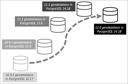

  • You can upgrade directly from an 11.x or 12.0 geodatabase if the PostgreSQL database is at a release that is supported for the current ArcGIS release.
    If the PostgreSQL database is not at a release that is supported for the current geodatabase release, you may have to upgrade the database and the geodatabase more than once before you can upgrade the geodatabase to the current release. The longer you go between geodatabase upgrades, the more upgrades you will have to do to get to the latest geodatabase release.
    For example, in the following scenario, you must upgrade the database and the geodatabase twice each.
    Upgrading from a much older geodatabase version requires a multiple-step upgrade of the database and geodatabase.
    For each intermediate geodatabase upgrade, follow the upgrade instructions for that geodatabase version, and test the geodatabase as you move from version to version. Similarly, follow the upgrade instructions from the database vendor for each database version, and test as you move from version to version.
