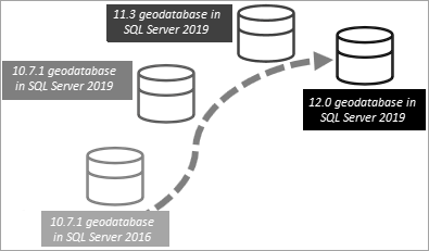

    If SQL Server is not at a release supported for the geodatabase version you upgrade from and the geodatabase version you upgrade to, you may have to upgrade the database and geodatabase multiple times before you can upgrade the geodatabase to the latest version. The longer you go between geodatabase upgrades, the more upgrades you will have to do to get to the latest geodatabase release.
    For example, in the following scenario, you will have to upgrade the database and the geodatabase:
    A 10.7.1 geodatabase in SQL Server 2016 may require multiple upgrades.
    For each intermediate geodatabase upgrade, follow the upgrade instructions for that geodatabase version, and test the geodatabase as you move from version to version. Similarly, follow the upgrade instructions from the database vendor for each database version, and test as you move from version to version.
