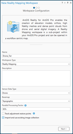

Workspace Configuration
The first stage in creating a Reality mapping workspace using drone imagery, is configuring the workspace. Follow the steps below to complete the Workspace Configuration stage:
  1. On the Imagery tab, click New Workspace.
  2. On the Workspace Configuration page, provide a name for the workspace.
  3. Ensure that Workspace Type is set to Reality Mapping.
  4. From the Sensor Data Type drop-down list, choose Drone.
  5. Optionally, from the Basemap drop-down list, choose a basemap as a backdrop for the image collection.
    You can also import and use an existing image collection for your workspace.
  6. Optionally, set the Parallel Processing Factor value of the workspace. The default value of 50% means that half of the total CPU cores will be used to support Reality mapping processing.
  7. Optionally, check the Track adjustment restore points check box to be able to revert your workspace to a previous state.
  8. Optionally, check the Import and use existing image collection check box to import and use an existing mosaic dataset. See Create a Reality mapping workspace from a mosaic dataset for more information.
    New Reality Mapping Workspace wizard Workspace Configuration page
  9. Click Next.
The wizard will progress to the Image Collection page.

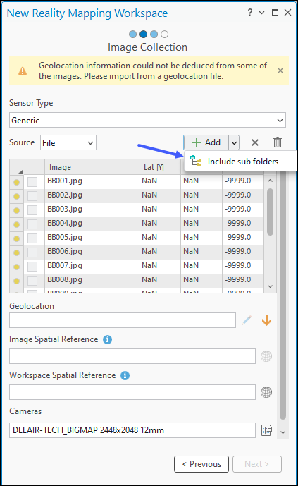

Image Collection
The Image Collection stage is where you specify the drone source imagery, define the camera, geolocation information, include lidar data, and spatial referencing.
  1. On the Image Collection page, ensure that Generic is chosen as the Sensor Type option.
  2. Click File from Source, click the Add button, browse to a folder, and load the imagery for the project.
    1. If the images are in subfolders, click the Add drop-down menu and choose the Include sub folders option.
    Each image will be displayed, and detailed information can be checked by hovering over it.
    Reality mapping Image Collection options for the drone imagery workspace
    Note:
    If the images are stored in a cloud environment, it is recommended that the Folder option be used as the Source. This is to improve the data loading speed over the network.
    It is recommended that images in one folder are captured by the same camera. The camera can be different for different folders. Also make sure the folder provided contains images, or a warning will be displayed and the Next button will be grayed out.
    The Geolocation and Cameras parameters are automatically populated from the metadata in the EXIF headers.
    If the images in the collection do not contain an EXIF header, provide a GPS text file for Geolocation, such as a comma-separated values file (.csv) that includes values for the Image Name, Latitude, Longitude, and Altitude fields, and optionally, the Omega, Phi, and Kappa or Roll, Pitch, and Yaw fields. Use the geolocation file provided with the drone imagery by your vendor.
    Note:
    To support accurate block adjustment, ensure that the camera model parameters, such as focal length, are accurately defined. On the Image Collection page, you can edit the camera model properties to align the camera parameters with the manufacturer’s specifications.

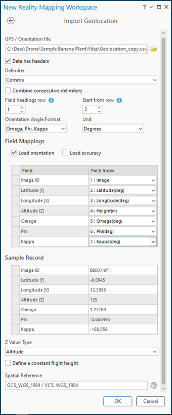

  3. Click the Import button Import to open the Import Geolocation window.
  4. For the GPS/Orientation file, click the Browse button Browse, browse to and select the GPS text file on disk, then click OK.
  5. Set the appropriate Delimiter value.
  6. For Field headings row, specify the row number where the field headings for the exterior orientation parameters begin.
    Note:
    You may need to make a copy and open the GPS file to determine the row number.
  7. For Start from row, specify the row number where the exterior orientation parameters begin.
  8. Select the appropriate Orientation Angle Format value and Unit from the drop-down list.
  9. Map the exterior orientation data fields appropriately using the options in the Field Mappings section.
  10. Review the accuracy of the field mappings in the Sample Record section.
    Reality mapping iMPORT geolocation options for the drone imagery workspace
  11. Click OK to accept the changes. You will be returned to the Image Collection pane in the wizard.

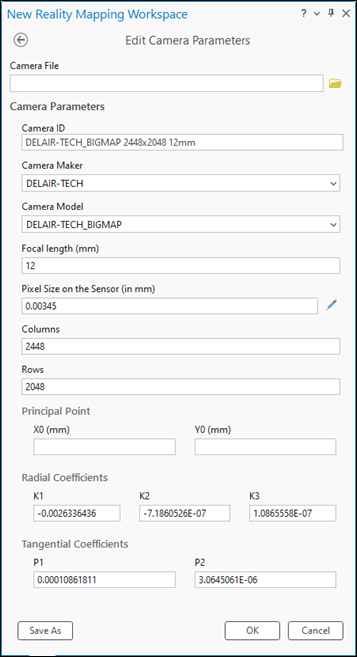

  13. If the camera type is missing from the EXIF header information, click the Properties button Properties to open the Edit Camera Parameters page and select the appropriate Camera Maker and Camera Model values.
    Edit Camera Parameters page for the drone imagery workspace
    Once you select the camera make and model, the wizard automatically populates the form based on the database of supported cameras and computes the camera model, also known as the interior orientation. If your camera is not supported, you can provide the camera information on the Edit Camera Parameters page and save it. The camera parameters settings will be used to compute the camera model.
    Note:
    Only the Focal length and Pixel Size on the Sensor values are required to compute the camera model. These values may be available in the image properties. If the values are not available, the Pixel Size on the Sensor value is automatically calculated for the 35 mm equivalent focal length for supported camera models using the equations below:
    \(Pixel \space Size \space = \space CCD \space Diagonal \space / \space Image \space Diagonal(in \space pixels)\)
    where
    \(CCD \space Diagonal \space = \space 2 \space * \space (Focal \space Length \space * \space Tan(FOV/2))\)
  14. If the Pixel Size on the Sensor value is not calculated automatically, click the Pixel Size on the Sensor button Edit Description; choose Field of view (FOV), 35 mm equivalent focal length, or Dimension from the Sensor Specification drop-down menu; provide the corresponding specifications for your camera model; and click OK.
    1. Choose the correct Camera File value with the camera model information.
      This can be a .cam file or a .csv file. If neither is available, provide the camera parameters on this page.
    2. Click the Back button to return to the Image Collection page.
    Pixel Size on the Sensor is now populated.
  15. When finished, click Next.

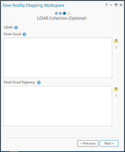

LiDAR Collection
Often, lidar data is simultaneously collected along with the drone imagery data. Add lidar point cloud and trajectory data using the optional LiDAR Collection page. This additional 3D data improves the quality of True Ortho, DSM, DSM Mesh, and 3D Mesh, products. The lidar data must have been collected simultaneously with the imagery to be processed. LAS or LAZ are acceptable formats for the Point Cloud data. For Point Cloud Trajectory, an SBET or SOL file is required. Both the Point Cloud and Point Cloud Trajectory files are mandatory requirements when integrating lidar data in the Reality mapping process.
  1. Optionally, add lidar data in the LiDAR Collection (Optional) page to support the product generation. Specify the location and files for both the lidar point cloud data and the associated trajectory file.
  2. Click Next to continue.

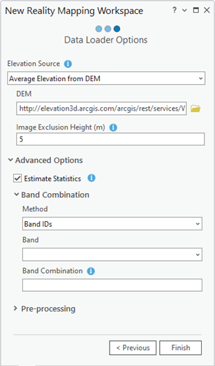

The Data Loader Options page is where you specify the Elevation Source, Advanced Options, and Pre-processing options.
  1. On the Data Loader Options page, choose an Elevation Source option.
    • If you have internet access, use Average Elevation from DEM for the Elevation Source parameter, and the default elevation service for the DEM parameter.
    • If you do not have internet access, provide a DEM file covering the project area, and choose Average Elevation for the Elevation Source value.
    • If you do not have internet access or a DEM file, choose the Constant Elevation option from the drop-down menu and provide an elevation value. This is only used as an initial estimate of the flight height for each image.
  2. Optionally, in the Advanced Options section, edit the Band Combination parameters to reorder the band combination from the default order.
    Data Loader Options page for a drone imagery workspace
  3. Click Finish to create the workspace.
