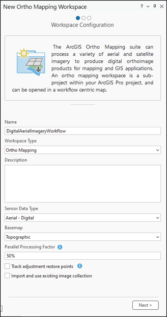

  3. On the Imagery tab, in the Ortho Mapping group, click the New Workspace drop-down menu and select New Workspace.
  4. In the Workspace Configuration window, enter a name for your workspace.
  5. Use the Workspace Type drop-down arrow to choose Ortho Mapping.
  6. For Sensor Data Type select Aerial - Digital from the drop-down menu.
  7. In the Basemap drop-down menu, choose Topographic.
  8. Optionally, set the Parallel Processing Factor value of the workspace.
    The default value of 50% means that half of the total CPU cores will be used to support Ortho mapping processing.
  9. Optionally, check the Track adjustment restore points check box to be able to revert your workspace to a previous state.
  10. Optionally, check the Import and use existing image collection check box to import and use an existing mosaic dataset.
  11. Click Next.

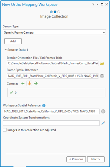

  12. In the Image Collection window, under Exterior Orientation File / Esri Frames Table navigate to the tutorial data folder on your machine and select the Frames table file (FrameTable.csv).
    This table specifies parameters that are used to compute the exterior orientation (EO) of your imagery. In the block adjustment process, these approximate values are refined to achieve higher accuracy.
    Make sure that the data paths listed in the raster column in the frame table file match the location of the image files on your machine.
  13. Under Cameras, click the Import button , navigate to the tutorial data folder on your machine, and select the camera table file (CameraTable).
    This file contains the interior orientation (IO) for the camera.
    For this tutorial, the Esri frame and camera tables have been provided in the proper format. For other data sets, you will likely need to build and format these tables. For more information, see Frame and Camera tables.
  14. Make sure the Spatial Reference and Camera Model are correct.
    Import frame and camera tables
    The default projection for the workspace is defined based on your imagery. This projection must match the coordinates used in the frame table, and it determines the spatial reference for your ortho products, including the orthomosaic and DSM. For this dataset, we’ll use the default projection.
  15. Click Next.

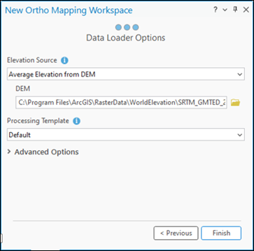

  16. Accept the default settings in the Data Loader window and click Finish.
If you have access to the internet, Elevation Source will be derived from the World Elevation Service. If you do not have access to the internet or a DEM, choose the Constant Elevation option from the drop-down menu and enter a representative elevation value.
DEM data loader

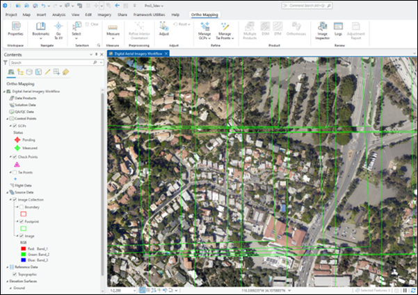

Once the workspace has been created, the images and image footprints will be displayed. An Ortho Mapping category has also been added to the Contents pane. The source imagery data and derived ortho mapping products will be referenced here.
The initial display of imagery in the workspace confirms that all images and necessary metadata were provided to initiate the workspace. The images have not been adjusted, so the alignment is only approximate at this stage, and the mosaic may not look correct.
Image collection

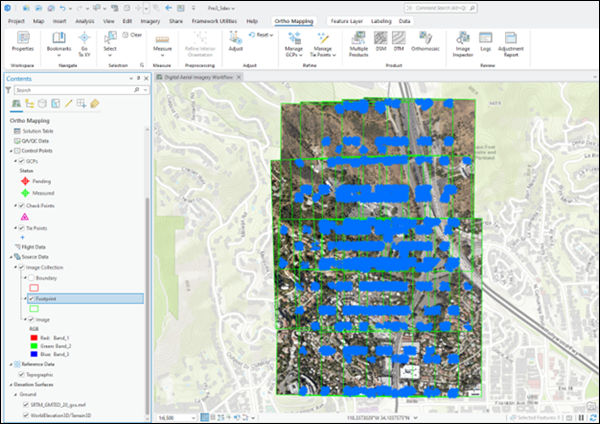

  4. After the adjustment is complete, turn on the Tie Points layer in the Contents pane to view the distribution of generated tie points on the map.
    Tie point distribution

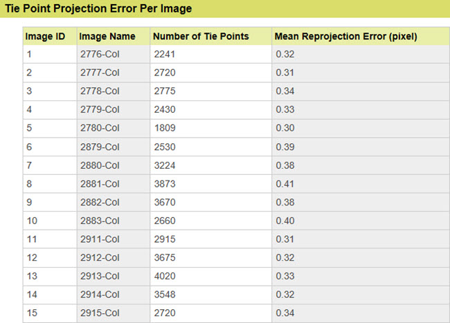

  1. In the Ortho Mapping tab, in the Review group, click Adjustment Report to generate adjustment statistics.
    The adjustment report provides a record of the adjustment and overall quality measures of the process.
    Adjustment report

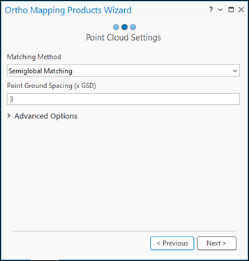

  3. In the Point Cloud Settings window, for Matching Method, choose Semiglobal Matching from the drop-down menu.
    This method is typically used for images of urban areas and captures more detailed terrain information.
  4. Accept the default value for the Point Ground Spacing parameter.
    This defines the spacing, in meters, at which the 3D points are generated. The default is five times the resolution of the source imagery.
  5. Accept all remaining default settings and click Next.
    For information on the Advanced Settings, see Generate elevation data using the DEMs wizard.

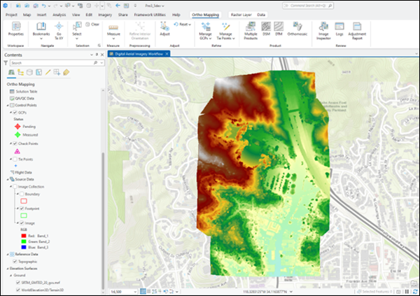

  6. In the DSM Settings window, under the Surface Type drop-down menu, choose Digital Surface Model.
  7. For Cell Size, use the default value of 3 x GSD. This will determine the resolution of the DSM (three times the imagery resolution).
  8. Accept the remaining default settings and click Finish.
    This process will take some time to complete.
    Elevation product

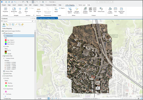

Generate an orthomosaic
Next, you will generate an orthomosaic. An orthomosaic is an orthorectified image product mosaicked from an image collection. Geometric distortion has been corrected and the imagery has been color balanced to produce a mosaic.

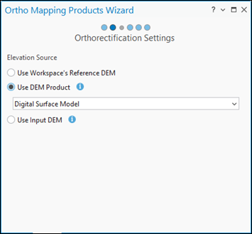

  4. In the Orthorectification Settings window, under Elevation Source, select Use DEM Product.
    This is the elevation product that was just generated.
  5. Ensure Digital Surface Model is the default option in the drop-down list below the Use DEM Product option.

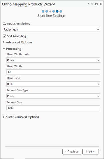

  7. In the Seamline Settings window, for Computation Method, select Radiometry in the drop-down list.
  8. Expand the Processing section, and input 20 for Blend Width.
  9. In Orthomosaic Settings window, for Pixel Size, use the default value. This will determine the final resolution of the orthomosaic.
    Seamline settings

  12. Click Finish to generate the final orthomosaic. This process will take some time to complete.
    Orthomosaic
