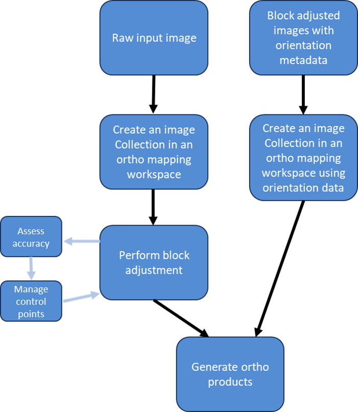

Ortho mapping with ArcGIS Pro requires three main steps:
  1. Create an ortho mapping workspace.
  2. Perform block adjustment to correct the geometric distortions in the imagery.
  3. Generate ortho mapping products.

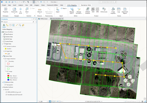

To get started, create a project. Next, create an ortho mapping workspace, which is a subproject in the ArcGIS Pro project. The ortho mapping workspace manages all the ortho mapping resources and opens a map view with an Ortho Mapping tab and an ortho mapping view in the Contents pane for the ortho mapping workflow. The Ortho Mapping tab provides tools and wizards for bundle block adjustment and the generation of ortho mapping products. The ortho mapping view in the Contents pane manages and visualizes the layers of the related data in the ortho mapping workspace.
Ortho mapping view
The ortho mapping workspace and the data stored in it depend on your source data. You can create an ortho mapping workspace for scanned aerial, digital aerial, satellite, or drone imagery. You can provide the ortho mapping wizard with a folder containing images, or you can use an existing mosaic dataset.
When your ortho mapping workspace is created, an Ortho Mapping category is created in the Catalog pane. Expand this to see the ortho mapping workspace you created, with an Imagery folder containing your source imagery and a Products folder where your ortho mapping products will be stored.
When your workspace is created, the Contents pane contains a variety of layers associated with the workspace, such as Control Points, Solution Points, and Data Products. These layers are empty until they are populated by initiating the proper steps in the ortho mapping workflow. For example, the Control Points layer is populated after performing block adjustment, and the Data Products layer is populated after performing ortho mapping product generation steps.

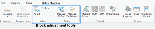

The block adjustment tools are available in the Adjust and Refine groups on the Ortho Mapping tab. You can modify the adjustment options, run the Adjust tool, add GCPs, or edit tie points. To import, modify, or delete GCPs, use the Manage GCPs tools. To edit or add tie points, use the Manage Tie Points tools.
