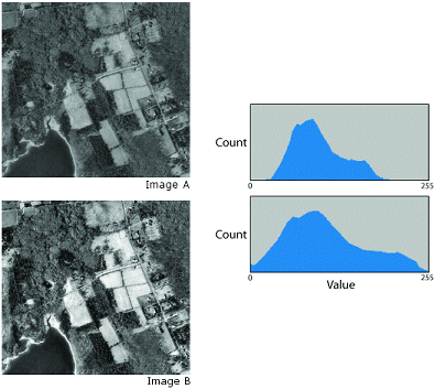

If the raster data represents continuous data, you can apply a contrast stretch to it based on the statistics of the raster dataset. A stretch increases the visual contrast of the raster display. For example, you can apply a stretch when the raster display appears dark or has little contrast. In these cases, images may not contain the entire range of values your computer can display, so you can stretch the image's values to use this range by applying a contrast stretch. This may result in a crisper image, and some features may become easier to distinguish.
An example of a contrast stretch is shown below. Histogram A represents the pixel values in Image A. By stretching the values (shown in histogram B) across the entire range, you can alter and visually enhance the appearance of the image (Image B).
Example of a contrast stretch
Different stretches produce different results in the raster display. You can experiment to find the best stretch for a particular raster dataset.
Standard stretches can be used with either the RGB Composite or Stretched renderer. The standard stretches are None, Minimum–Maximum, Percent Clip, Standard Deviation, Histogram Equalize, Custom, and Esri.
The minimum–maximum stretch spreads out tightly grouped values. A two-standard deviation stretch is often used to brighten raster datasets that normally appear dark. A percent clip stretch removes the outliers at the low and high ends of the histogram tails. The histogram equalize stretch spreads out the values across the histogram equally. The custom stretch uses the values from your interactive histogram manipulation. The Esri stretch requires that the raster dataset statistics (and its histogram) be computed or estimated; this method provides a good overall stretch with imagery by preventing pixel values from being stretched to the extremes.

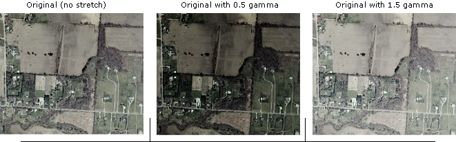

You can also apply a gamma stretch to raster data. When preparing raster data for computer display, the gamma refers to the degree of contrast between the mid-level gray values of a raster dataset. Gamma does not affect the lowest or highest values in a raster dataset, only the middle values. By applying a gamma correction, you can control the overall brightness of a raster dataset. Gamma values less than one decrease the contrast in the darker areas and increase the contrast in the lighter areas. This darkens the image without saturating the dark or light areas of the image and brings out details in lighter features. Conversely, gamma values greater than one increase the contrast in darker areas, such as shadows from buildings. Gamma values greater than one can also bring out details in lower elevation areas when working with elevation data. Additionally, gamma changes not only the brightness but also the ratios of red to green to blue.
In the example below, the effect of adjusting the gamma values used to display a raster dataset is shown. Each of the values was added to the red, green, and blue bands. By applying different values to each band, you can adjust the degree of red, green, and blue displayed in the color composite image.
Examples of using gamma

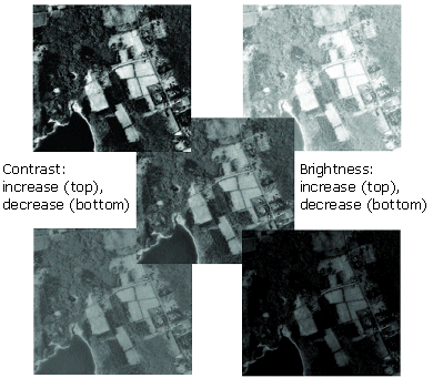

You can interactively adjust the brightness , contrast , or gamma , which are on the Raster Layer, Mosaic Layer, or Image Service Layer tabs. These enhancements are applied to the rendered screen display, not to the original raster dataset values. Brightness increases the overall lightness of the image—for example, making dark colors lighter and light colors whiter—while contrast adjusts the difference between the darkest and lightest colors. The following is an example of adjustments made to the brightness and contrast of an image:
Examples of brightness and contrast adjustment

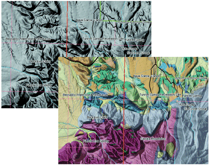

The transparency tool allows you to see data layers under the raster layer. In the example below, the top image does not use transparency, and the hillshade obscures the underlying land-use layer. With transparency enabled (the bottom image), the underlying symbology appears through the hillshade, producing a three-dimensional effect.
Example of transparency

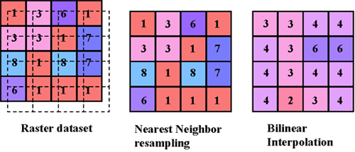

Resampling a raster dataset alters the way it is displayed. Resampling is the process of interpolating new pixel values while transforming the raster dataset when it undergoes a geoprocessing function or when it changes coordinate space. The four resampling techniques are nearest neighbor, bilinear interpolation, cubic convolution, and majority.
For discrete raster datasets, such as those found in classified imagery including land-use maps or soil maps, the nearest neighbor and majority resampling algorithms are most appropriate. The nearest neighbor technique assigns the closest pixel value to the pixel. The majority technique assigns the most popular value in the filter window, providing a smoother look.
For continuous raster datasets—such as a satellite image, an elevation model, or an aerial image—bilinear interpolation or cubic convolution is more appropriate. The bilinear interpolation technique creates a smooth-looking result. The cubic convolution technique creates a sharper-looking result but takes longer to process. The exception is when preserving the radiometry of an image for accurate multispectral analysis; in this case, nearest neighbor is the most appropriate technique.
The diagram below shows an example of display resampling. The first image shows the original raster and the new position of the raster (outline of the raster). The center image shows how the nearest neighbor resampling technique resamples the data. The last image shows how bilinear interpolation resamples the raster.
Examples of nearest neighbor and bilinear interpolation resampling techniques
