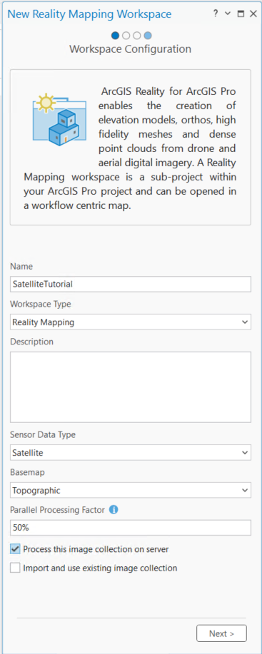

  4. On the Imagery tab, in the Reality Mapping group, click the New Workspace drop-down menu and choose New Workspace.
  5. On the Workspace Configuration page, type a name for the workspace.
  6. Ensure that the Workspace Type option is set to Reality Mapping.
  7. From the Sensor Data Type drop-down list, choose Satellite.
  8. Optionally, from the Basemap drop-down list, choose a basemap as a backdrop for the image collection.
  9. Set the Parallel Processing Factor. This controls the maximum computational resource for distributed processing. It is recommended to use percentage expression. For example, if you have 2 Reality Server nodes, set Parallel Processing Factor to 50% will utilize one machine to do block adjustment and generate reality mapping products.
  10. Check Process this image collection on server.
    Important:
    You won't see this option if you are not connected to a portal or your active portal connection is not configured for ArcGIS Reality Server.
  11. Click Next.
    Workspace Configuration for a new reality mapping project

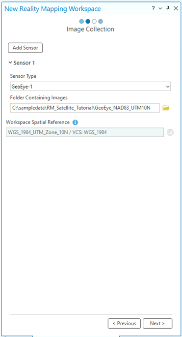

  12. In the Image Collection window, under the Sensor Type drop-down menu, choose GeoEye-1.
  13. Under Folder Containing Images, click the Browse button and browse to the tutorial data folder on your machine and select the imagery folder (GeoEye_NAD83_UTM10N), then click OK.
    The supported Workspace Spatial Reference information is automatically populated, and the option to add the spatial reference information manually is grayed out. If the system cannot automatically determine the appropriate spatial referencing, manual entry of this information is enabled.
    Satellite image collection options for new reality mapping Workspace

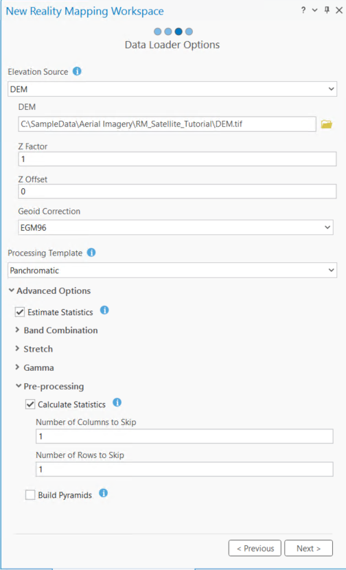

  15. In the Data Loader window, under Elevation Source, choose DEM. Under DEM, browse to the DEM provided with the tutorial dataset.
    Note:
    This DEM will be used to support the block adjustment process.
  16. Most elevation data uses orthometric heights, so you will need to apply a geoid correction. Under Geoid correction, ensure EGM96 is selected.
  17. Under Processing Template, choose Panchromatic.
  18. Expand Advanced Options.
  19. Ensure Estimate Statistics option is checked.
  20. Expand Pre-processing and ensure Calculate Statistics is checked. This will expose the calculate statistics options.
    Satellite data loader options for reality mapping workspace

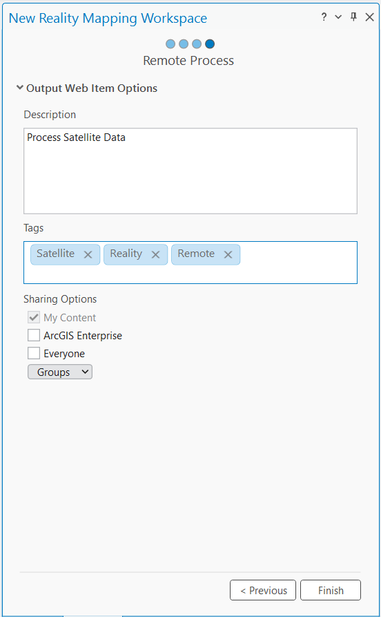

  22. You can provide Description and Tags for the image service and click Finish.
    Remote process description and tags for reality mapping workspace

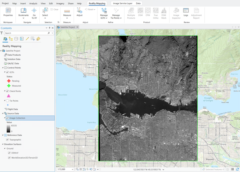

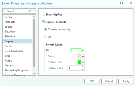

Once the workspace has been created, a Reality Mapping category will be added to the Contents pane, where the image collection image service and derived Reality mapping products service will be stored. To see the image footprints, you can right click on the Image Collection in the Contents pane > Properties > Display > Check on Display Footprints.
Image Collection Layer Properties
The initial display of imagery in the workspace confirms that all images and necessary metadata were provided to initiate the workspace. The images have not been aligned or adjusted, so the mosaic may not appear geometrically correct. You may need to zoom in close enough to see the image.
A new Reality Mapping tab will be added to the ArcGIS Pro main menu. Clicking this tab will expose a series of tools and workflows dedicated to Reality mapping. In the Product category, all the buttons are unavailable because the images are not yet adjusted.
Satellite image collection after creating a reality mapping workspace

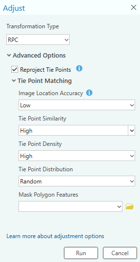

  1. On the Reality Mapping tab, in the Adjust group, click Adjust Adjust.
  2. In the Adjust window, under Transformation Type, choose RPC. The Rational Polynomial Coefficients (RPC) transformation will be applied in the adjustment, which is used for satellite imagery that contains RPC information within the metadata.
  3. Check the box next to Reproject Tie Points.
    This will ensure that the tie point map coordinates are calculated.
  4. Under Tie Point Matching in the Adjust pane, ensure your parameter settings match those in the example below.
    Block adjustment option for satellite
  5. Click Run to perform block adjustment.

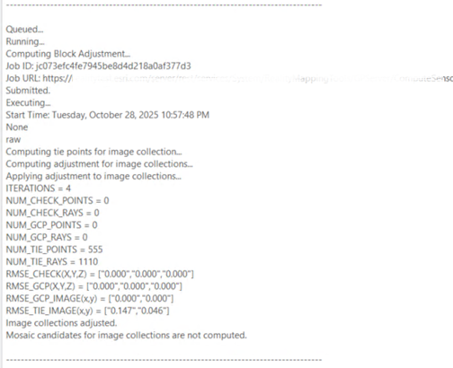

  6. Tie point residuals or accuracy reporting can be viewed in the logs file. On the Reality Mapping tab, in the Review group, click Logs Logs view to access Logs file. Tie point residuals are displayed in the row labeled RMSE_Tie_Image(x,y). The units for tie point RSME is pixels.
    Your residual may differ slightly from the example below.

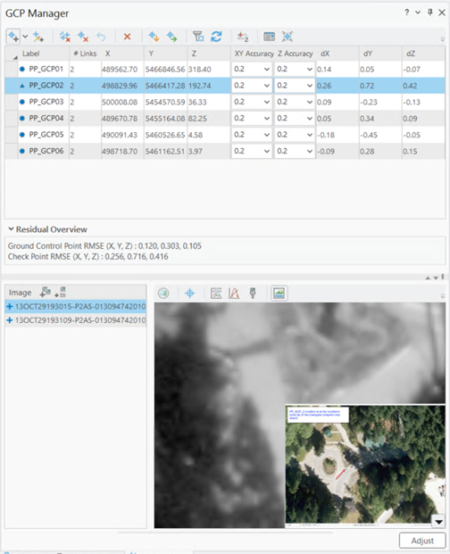

  1. On the Reality Mapping tab, in the Refine group, click Manage GCPs to open the GCP Manager.

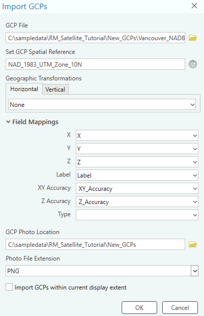

  2. In the GCP Manager window, click the Import GCPs button Import GCPs.
  3. In the Import GCPs window, browse to and select the GCP file (Vancouver_NAD83-UTM10N.csv). Click OK.
  4. Under Set GCP Spatial Reference, click the Browse button Browse spatial reference. For Current XY, expand Layers, and choose NAD 1983 UTM Zone 10N (WKID 26910). Accept all other defaults and click OK to accept the changes and close the Spatial Reference window.
    The Current Z, or vertical coordinate system (VCS), was not set because the digital elevation model used to extract height values for the GCPs did not have a VCS defined. If the DEM you used had a defined VCS, the Current Z (VCS) would have been set with matching coordinates.
  5. For Geographic Transformations, accept the defaults. No transformations are required, as the horizontal spatial reference of the GCPs and the workspace are the same.
  6. Ensure the field mappings are correct.
  7. Click the browse button below GCP Photo Location and browse to and select the folder containing the images of the GCP locations. Click OK.
  8. For Photo File Extension, choose PNG from the drop-down list.
    Import GCP to improve adjustment of satellite imagery
  9. Click OK to import the GCPs.
    Once the GCPs have been imported, the table in the GCP Manager will be populated.
    GCPs added to the projects
  10. To add tie points for the selected GCP, in the Preview section, click the View GCP Photo button View GCP photo to display the GCP image chip. Use the mouse wheel to zoom in on the image chip to see the GCP location indicated by a red arrow.
  11. Click the drop down next to the Add GCP or Tie Point button Add tie points in the GCP Manager window and select Semi-Auto to add a tie point in the image viewer for each image.
    The tie points for other images will be automatically calculated by the image matching algorithm where possible, although each tie point should be checked for accuracy. If the tie point is not automatically identified, add the tie point manually by selecting the appropriate location in the image.
  12. Repeat steps 10 and 11 to select and add tie points for the remaining GCPs.
  13. After each GCP has been measured with tie points, select point PP_GCP02 and right-click to change it to a Check Point. This point will be excluded in the adjustment process and will instead be used to independently assess the accuracy of the adjustment results.
  14. After adding GCPs and checkpoints, the adjustment must be run again to incorporate these points. Click Adjust.
    GCP Manager

Adjustment quality results can be viewed in GCP Manager by analyzing the residuals for each GCP. Residuals represent the difference between the measured and computed position of a point. They are measured in the units of the project spatial referencing system. After completing adjustment with GCPs, three new fields, dX, dY, and dZ, are added to the GCP Manager table and display the residuals for each GCP. The quality of the fit between the adjusted block and the map coordinate system can be evaluated using these values. The Root Mean Square Error (RMSE) of the residuals can be viewed by expanding the Residual Overview section of GCP Manager.
Review satellite adjustment result
