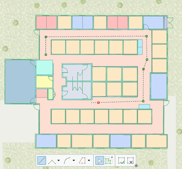

  8. In the Create Features pane, click Line to create a line feature.
  9. Draw the line where you want to sketch a survey path, as shown in the example below.
    Example of creating a survey path feature
  10. Save your edits.
  11. Use the floor filter to select the next level for which you want to plan recordings, and repeat steps 4 through 10.
Survey paths created in the IPS Recordings layer can be used to perform a survey with the IPS Setup app.
