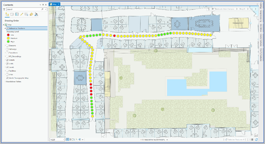

Identify the accuracy levels
The Accuracy Level field in the Reference Positions feature class represents a classification of the positioning performance based on the distance between your actual location and the location computed by the ArcGIS IPS engine.
Symbolizing the reference position features on a map allows you to visualize and identify areas where ArcGIS IPS performs at different levels of accuracy.
To identify accuracy levels, complete the following steps :
Add the Reference Positions feature class to a map.
Configure the map as floor aware.
Configure the Reference Positions layer as floor aware.
Choose the Reference Positions layer in the Contents pane.
On the Feature Layer tab, in the Drawing group, click the arrow below Symbology
and choose Unique Values
.The Symbology pane appears, where you can further customize the way the layer is classified and symbolized.
Click the Field 1 drop-down arrow and choose Accuracy Level.
The color of the reference position features are based on the
Accuracy Levelfield, allowing you to visualize areas with different levels of accuracy.

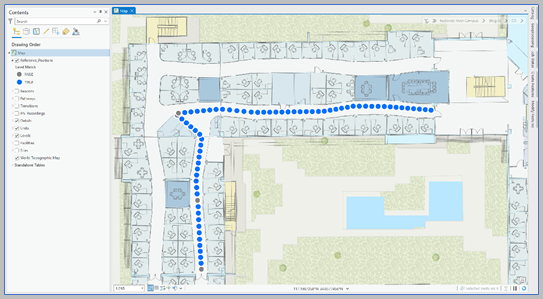

Match location level
The Level Match field of the Reference Positions feature class reports if your actual location and the location computed by the ArcGIS IPS engine are at the same level.
Symbolizing the reference position features on a map allows you to visualize and identify the areas where ArcGIS IPS locates you on the wrong floor.
To match location levels, complete the following steps:
Click the Field 1 drop-down arrow and choose Level Match.
Level Matchfield, allowing you to visualize areas with mismatched levels.

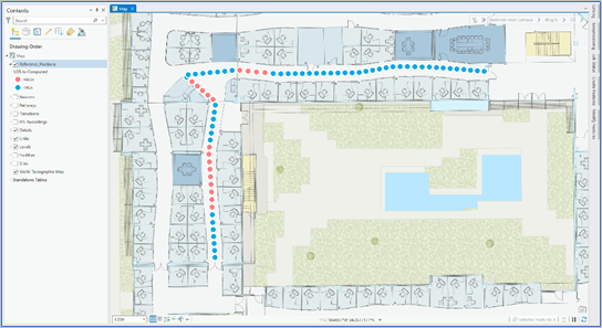

Visualize line of sight
The LOS To Computed field of the Reference Positions feature class reports if there is a line of sight between your actual location and the one computed by the ArcGIS IPS engine.
Symbolizing the reference position features on a map allows you to visualize and identify areas where ArcGIS IPS locates you outside the line of sight of your actual position.
To visualize line of sight, complete the following steps:
Click the Field 1 drop-down arrow and choose LOS To Computed.
LOS To Computedfield, allowing you to visualize areas where you are located outside the line of sight.

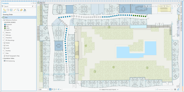

Set the location source
The Location Source field of the Reference Positions feature class indicates the technology used by the ArcGIS IPS engine to compute your position. The supported location sources are Bluetooth, Wi-Fi, Apple indoor positioning, and Global Navigation Satellite System (GLONASS).
Note:
The location source may differ from the type of positioning supported by an Indoor Positioning Data Service. This is because the ArcGIS IPS engine also uses other available sources to compute the best possible indoor location.
Symbolizing the reference position features allows you to visualize which location technology is used in different areas of your environment and perform appropriate steps to correct unexpected behaviors. For example, if you have a Bluetooth-based deployment, and the areas use GLONASS instead, review your beacon deployment and ensure that you define proper entrance and exit transitions.
To visualize location sources, complete the following steps:
Click the Field 1 drop-down arrow and choose Location Source.
Location Sourcefield, allowing you to visualize and identify areas where the ArcGIS IPS engine is using different location sources.

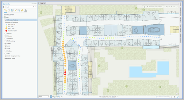

Set a custom accuracy level
The Distance to Computed field in the Reference Positions feature class reports the Euclidean distance between your actual location and the location computed by the ArcGIS IPS engine.
By applying a graduated colors symbology to the reference position features and defining custom classes, you can gain a finer-grained and personalized view of the level of positioning accuracy across your environment.
To set a custom accuracy level, complete the following steps:
and choose Graduated Colors
Click the Field drop-down arrow and choose Distance to Computed.
Click the Classes drop-down arrow and choose the number of classes the data should be divided into.
Click the Method drop-down arrow or apply a manual interval for class breaking to define the method of division.
Distance to Computedfield, allowing you to visualize areas with different levels of accuracy.

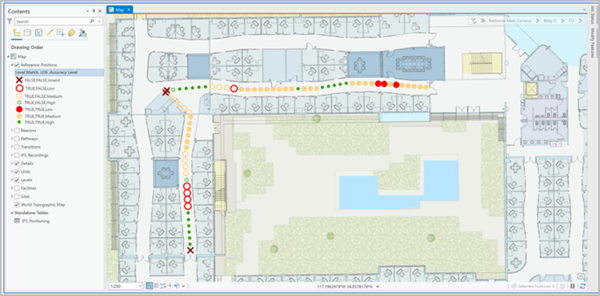

Combine the analysis
You can visualize data by combining multiple fields of the Referenced Positions feature class. A multifield visualization allows you to identify trends based on field correlation that may have contributed to suboptimal ArcGIS IPS performance.
Symbolizing the reference position features on a map by combining the Level Match, LOS to Computed, and Accuracy Level field values gives you a general overview of the quality of your deployment.
To visualize ArcGIS IPS performance by combining analysis fields, complete the following steps:
Click Add Field, and in the newly added field, choose LOS to Computed from the drop-down list.
Click Add Field, and in the newly added field, choose Accuracy Level from the drop-down menu.
The colors of the reference position features are based on the
Level Match,LOS to Computed, andAccuracy Levelfield values, allowing you to simultaneously visualize areas that may have a level mismatch, be out of the line of sight, or have a low accuracy level.
