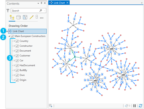

A link chart is composed of point features that represent entities and line features that represent relationships in a knowledge graph. These link charts are created and opened in a link chart view , and appear in the Maps category in the Catalog pane and the catalog view.
The link chart itself is represented at the top of the Contents pane in the same manner as a map (number 1 in the image below). The knowledge graph is represented as a knowledge graph layer (number 2 in the image below).
You can visualize a knowledge graph layer in a link chart.
The knowledge graph layer is composed of one link chart layer for each entity type and each relationship type in the knowledge graph (number 3 in the image above). Each link chart layer is a composite layer in turn, as described below.

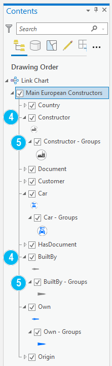

  • Link chart layer—This layer represents entities or relationships in the knowledge graph (number 4 in the image below). The default name for this layer corresponds to the name of the entity type or relationship type.
  • Link chart aggregation layer—Entities and relationships can be grouped together visually in a link chart. The link chart aggregation layer represents these grouped entities or grouped relationships in the link chart (number 5 in the image below). The aggregation layer allows you to provide different symbology for grouped entities and relationships. The default name for this layer corresponds to the entity or relationship type name with the " - Groups" suffix.
Link chart layers contain link chart aggregation layers.
As with feature layers in a map, you can change how link chart layers and link chart aggregation layers are visualized in the link chart using the Link Chart Layer and Link Chart Aggregation Layer tab sets on the ribbon and the Layer Properties dialog box.
