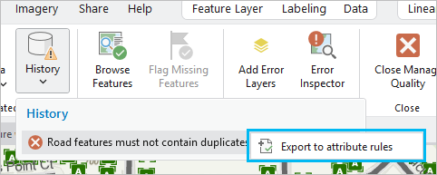

  1. In the Automated Review group, click the History drop-down menu, right-click the result, and click Export to attribute rules.
    The Run Data Check History drop-down menu with the option to Export to attribute rules
    The Select Output .csv Location dialog box appears.
  2. Browse to the tutorial project folder to save the rule configuration: <extracted file location>\DataReviewer_AttributeRules\Implement_automated_QC.
  3. Click OK.
    A notification appears stating the number of checks and .csv files exported.

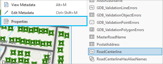

  4. Click the Catalog tab if you have not already done so.
  5. In the Catalog pane, click the Databases drop-down, click the datareviewertutorial.gdb drop-down, and right-click the RoadCenterline feature class, and click Properties.
    Road Centerline feature class with the properties option highlighted
    The Feature Class Properties: RoadCenterline dialog box appears.
  6. Click Manage.
  7. Verify that Global IDs and Editor Tracking are enabled.
    Note:
    Global IDs have been added to the datasets and editor tracking is enabled for this tutorial, but you must do these two things when you configure rules for your own data.
  8. Once verified, click OK.

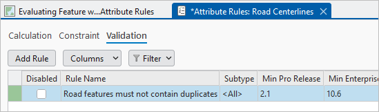

  14. Click the Validation tab.
    Duplicate Feature check in green under the Validation tab
    The rule appears under the Validation tab.

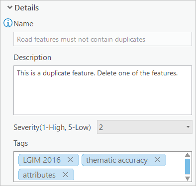

  15. In the Road Features must not contain duplicates check pane, scroll down to the Details section and configure the properties that will store results for features that fail validation:
    1. Type This is a duplicate feature. Delete one of the features. in the Description text box.
    2. Click the Severity(1-High, 5-Low) drop-down arrow and choose 2 to set the relative importance for results of this type compared to others.
    3. Type LGIM 2016, thematic accuracy, attributes in the Tags text box and press Enter.
      Tip:
      Tags can be used to enable requirements traceability. Consider including the data model and version for which the rule is related or including an ISO-19157 data quality element, such as thematic accuracy.
      Details for Duplicate Feature check

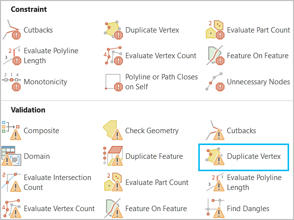

  2. On the Attribute Rules tab, in the Add Rules group, click the Ready to Use Rules drop-down gallery to display ArcGIS Data Reviewer automated checks.
    Note:
    The contents of the Ready to Use Rules gallery is a smart gallery that varies depending on the chosen data source.
  3. From the Ready to Use Rules gallery, in the Validation section, click Duplicate Vertex to add a new rule.
    Duplicate Vertex check in the Ready to Use Rules gallery
    The new rule appears in the Attribute Rules view with a red row header, indicating that required parameters are missing from the rule's configuration.

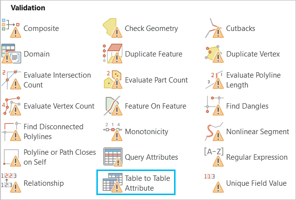

  1. On the Attribute Rules tab, in the Add Rules group, click the Ready to Use Rules drop-down gallery to display ArcGIS Data Reviewer automated checks.
    Note:
  2. From the Ready to Use Rules gallery, in the Validation section, click Table to Table Attribute to add a new rule.
    Table to Table Attribute check in the Ready to Use Rules gallery
