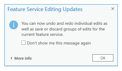

Editing a web feature layer, or those referencing data in an enterprise geodatabase, for the first time from a version of ArcGIS Pro that did not support undo and redo shows the following message.
Feature Service Editing Updates

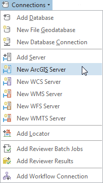

  1. On the Insert tab, in the Project group, click the Connections drop-down menu .
  2. Click New ArcGIS Server .

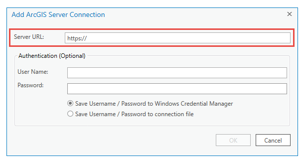

  3. In the Server URL box, type the full URL for the server to which you want to connect.
    For example, the following URL adds a connection to a sample server: https://sampleserver6.arcgisonline.com/ArcGIS/services
    Add ArcGIS Server User Connection
  4. If required, type your user name and password.
    If you want to save your user name and password information to avoid entering it each time you connect, choose the appropriate Save Username/Password setting.
  5. Click OK.

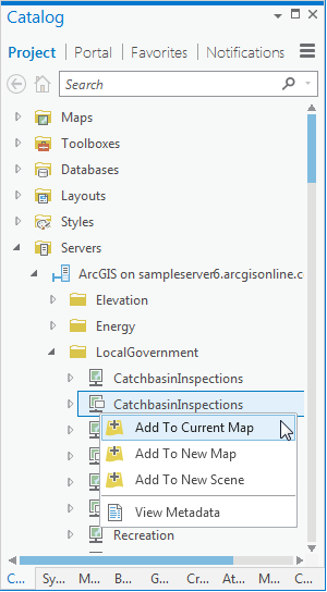

  6. In the Catalog pane, expand Servers and expand the ArcGIS Server connection containing the feature service.
    Feature services
  7. Add the web layer or web map using one of the following methods:
    • Drag the map service onto the map.
    • Right-click the map service and click Add To Current Map .
