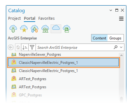

  4. In the Catalog pane, click the Portal tab and click the portal content tab containing the network feature layers you are editing, for example, ArcGIS Online .
  5. Right-click the utility network feature layer, click Add To New and click Map .
    Portal content
    The utility network feature layer, for example, ClassicNapervilleElectric_Postgres_1, is added to a new map in the current project.

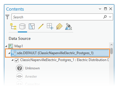

  2. In the Contents pane, click the List by Data Source tab , and click the feature service, for example, SDE.DEFAULT (ClassicNapervilleElectric_Postgres_1).
    Contents pane
    The Versioning tab appears on the ribbon.

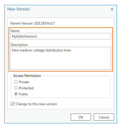

  4. On the New Version dialog box, click the Name text box and enter a name for the version you are creating.
    To further document the version, click the Description text box and enter a brief statement that explains the purpose of the new version.
    New Version
  5. In the Access Permission section, click one of the following:
    Private
    Allow only the owner or the geodatabase administrator to view or modify the version.
    Protected
    Allow anyone to view the version, but only the owner or the geodatabase administrator can edit the version.
    Public
    Allow anyone to view or edit the version with read-write (update, insert, and delete) permissions.
  6. Check the Change to this new version check box.
  7. Click OK.

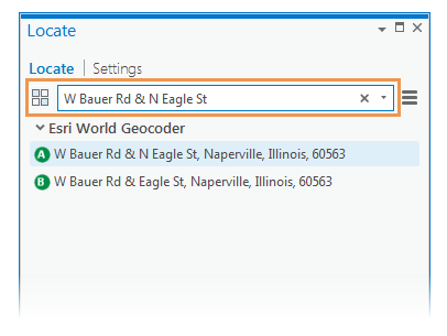

  1. On the ribbon, click the Map tab. In the Inquiry group, click Locate .
  2. In the Locate pane, type the address or street intersection, for example, W Bauer Rd & N Eagle St, and press Enter.
    A list of address candidates appears in the pane.
    Locate pane
  3. Double-click the address candidate.
    Alternatively, right-click and click Zoom To or Pan To .
    The map zooms or pans to the address or street name.

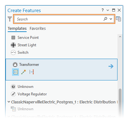

  2. On the Edit tab, in the Features group, click Create .
    The Create Features pane appears.
  3. In the Create Features pane, click a feature template that creates network features.
    To find a feature template containing a specific word or phrase, click the Search box and enter your search criteria. Search is not case-sensitive.

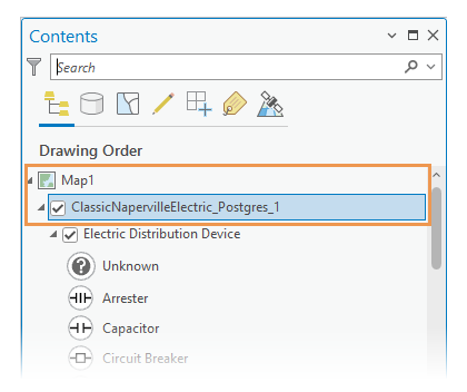

  1. In the Contents pane, click the List by Drawing Order tab and click the utility network feature layer you edited.
    To view network feature layer properties such as rules and associations, right-click the layer and click Properties .
    Contents pane

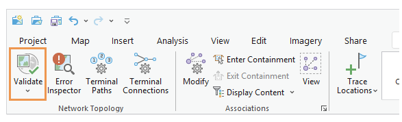

  2. On the ribbon, click the Utility Network tab. In the Network Topology group, click the Validate drop-down arrow, and click Current Extent .
    Validate
    The network topology is validated and the dirty areas are cleared.
