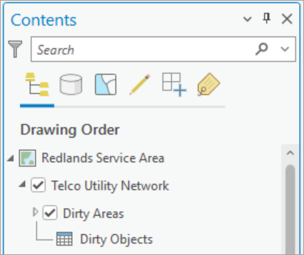

Access dirty objects
The dirty objects table is a system-maintained table used to store information about edits made to nonspatial objects and associations in a telecom domain network. To access the dirty objects table, add a utility network layer that contains a telecom domain network to an active map view.
To access the dirty objects table for a utility network, complete the following steps:
  1. Ensure that the utility network and related layers are added to an active map view.
  2. In the Contents pane, expand the utility network layer.
    You can now view and explore the Dirty Objects table.
    Dirty Objects table in an expanded utility network layer
