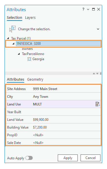

Edit attributes and related records
Select features in the map using the Select tool
, click and highlight the features in the selection view, and edit the attribute values on the Attributes tab. To follow a hyperlink stored in a field, press Ctrl and click the text in the field.
Click the ribbon Edit tab and click Attributes
in the Selection group.Alternatively, use one of the following methods:
Right-click a layer In the Contents pane on the List by Selection tab
.Click Attributes
on the Map ribbon tab, in the Selection group.Press Ctrl+Shift+T.
The Attributes pane appears.
Click the Selection tab in the Attributes pane.
Click the Select one or more features tool
, and select the features.If features are currently selected, the selection tool displays Change the selection.
To refine the selection in the selection view, right-click a feature or layer and click Unselect
or Only Select This
.Note:
If the selection is filtered by an editing tool, the An active editing tool is filtering the selection. Deactivate the tool to restore the selection notification
appears in the pane. To reset the selection, press Esc to disable the active tool or click the Select tool
and make a new selection.The selected features appear in the selection view in a collapsable list.
In the selection view, click the feature or nonspatial object containing the attributes you are editing.
If a Warning icon
appears next to a related layer or table, click the selected record to edit the attribute fields in the pane, or right-click and click Add To Map
.Alternatively, to edit the same attribute fields for multiple features and apply the same value, use one of the following methods:
Press the Ctrl key, and click the features.
To edit attributes for a range of features, press Shift and click the first and last feature in the selection.
To edit attributes for all features on the same layer, click the layer name.
Attribute fields for the items highlighted in the selection view appear in the attributes view on the Attributes tab. Their appearance is determined by field properties that are stored on the layer, for example, visibility, read-only, and highlight settings.
Click the Auto Apply toggle button
and turn it on or off.On
Automatically apply edits when Enter is pressed or if the pointer focus is clicked out of the field. This setting disables the Apply and Cancel buttons.
Off
Require edits to be manually applied or canceled. This setting enables the Apply and Cancel buttons.
If this button is disabled and can't be changed, consult your system administrator.
Click the Attributes tab.
If the selected attribute is stored in an attributed relationship table, click the Attributed Relationship tab.
Click a field, edit its value, and press Enter.

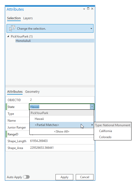

Edit contingent values
To edit contingent values, click the field and choose a value on the drop-down list. If Auto-update is enabled in the attribute table, the values in participating contingent fields automatically update when a unique combination is encountered.
Contingent values act as loosely constrained look up fields for attribute domains. The participating fields are defined as a group in which specifying a value in one field determines the next set of valid choices for other fields.
Tip:
To create and manage contingent values, open the source attribute table and click the Data tab on the ribbon. In the Design group, click Contingent Values
On the Edit ribbon tab, click Attributes
in the Selection group.The Attributes pane appears.
In the Attributes pane, click the Selection tab and select the feature.
Click the Select tool
and select a feature defined with contingent attribute values.In the selection view, click the feature.
Click and turn off Auto Apply
.Click a field and choose a value on the drop-down list.
The specified value filters the lists of values in other contingent fields to show valid combinations. Incorrect values highlight the field with a vertical yellow bar and show a warning message in the pane.
It is recommended that you start at the top of the value hierarchy and choose values in subsequent fields that are valid choices. Additionally, you can click the controls described in the following table that appear in drop-down lists depending on the available combinations:
Show Matches
Show all valid choices for the field based on its primary field value. This is the default setting. This control appears at the top of the drop-down list when you click Show All.
Partial Matches
Show domain values grouped according to matched fields. This control allows you to create partial matches that are still valid combinations with a subset of the contingent fields for the row. Other fields may require further editing until a valid combination is achieved.
Show All
Show all domain values for the field including retired and nonvalid combinations. This control allows you to create a completely different combination of values. This control appears at the bottom of the drop-down list when you click Show Matches.
Click Apply to apply your changes.

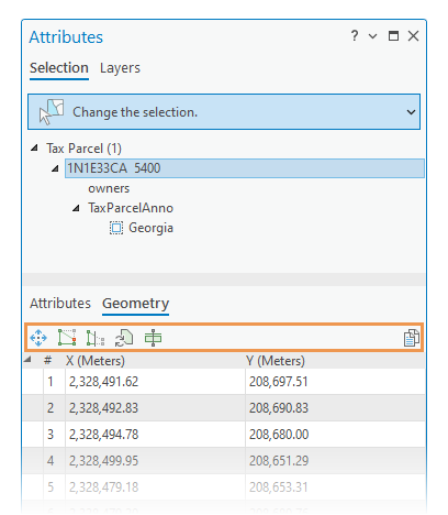

View, edit, or copy geometry coordinates
, you can view, edit, or copy geometry coordinates values to the clipboard using commands on the Geometry tab toolbar. The toolbar includes shortcuts to common editing tools for editing the geometry of the currently selected feature.
When you view, edit, or copy coordinate values, consider the following:
To change the display units, click the coordinate display arrow at the bottom of the current map or scene view.
To copy the coordinate values in the geometry properties table to the clipboard, select the rows and click Copy
on the toolbar. You can paste them to other elements in ArcGIS Pro such as text graphics or to other applications such as Microsoft Excel.
