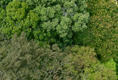

Besides human-made structures, natural objects such as vegetation can be visualized with high fidelity. This includes tree leaves, enabling classification of tree species or other types of vegetation. Additional visual effects such as fog, smoke, or water reflection can also be visualized, allowing you to capture the most natural appearance possible.
Gaussian splat vegetation
A Gaussian splat layer represents trees.

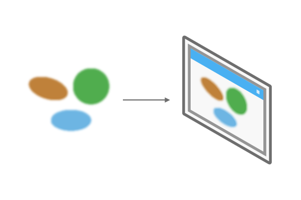

3D Gaussian splatting is a technique used in real-time radiance field rendering. It uses a neural field for reconstructing a three-dimensional representation of a scene from two-dimensional images. This volume rendering technique is based on millions of fuzzy ellipsoids and created using an adaptive process. Each Gaussian splat is defined by its position, rotation, size, color, and transparency. When rendered together, these Gaussian splats blend to form a smooth photorealistic representation in 3D.
Diagram showing individual splats
A diagram shows individual splats rendered on the screen.
Depending on the viewer's perspective or viewing direction, Gaussian splats adapt dynamically in terms of their color and intensity. This allows you to realistically depict reflective materials when navigating around them. If there is not enough oblique imagery for the areas available during processing, the Gaussian splats will be missing or only a view ellipse will be present.
