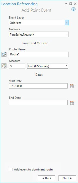

    Using the Route and Measure method, the measure location is based on the measure values from the selected route.
  3. Click Next.
    The Route and Measure and Dates sections appear in the Add Point Event pane.
  4. Click the Event Layer drop-down arrow and choose the point event layer where you want to add the event.
    The selected Network value is based on the selected event layer.
  5. Specify a route by doing one of the following:
    • Provide a route name in the Route Name text box.
    • Click Choose route from map , and click the point on the route where you want to add the point event.
    The measure is initially populated using the route location where you clicked.
    You can choose a new measure using Choose measure from map .
    Tip:
    After clicking Choose route from map or Choose measure from map , hover over the route to see the route and measure at the location of the pointer.
    Learn more about setting map scale options for the display of route and measure information
    Note:
    If a message regarding acquiring locks or reconciling appears, conflict prevention is enabled.
    After a route is selected, the tool will attempt to release the route lock if the route lock is acquired by the current user in a different version and its releasable status is yes.
  6. Specify a new location by doing one of the following:
    • Provide the value in the Measure text box.
    • Click Choose measure from map , and click the measure value along the route on the map.
    Once the measure is provided, a green dot appears on the map at that measure location.

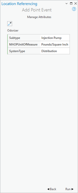

    The attributes for the chosen point event layer appear under Manage Attributes.
    Manage Attributes table
  10. Provide attribute values for the event layer.
    Note:
    Click Copy attribute values by selecting event on the map and click an existing point event belonging to the same event layer on the map to copy event attributes from that event.
    Note:
    After events are selected, event locks are acquired or transferred to the current user in the current version.
    Unlike route locks, there is no attempt to release event locks in any editing activity.
