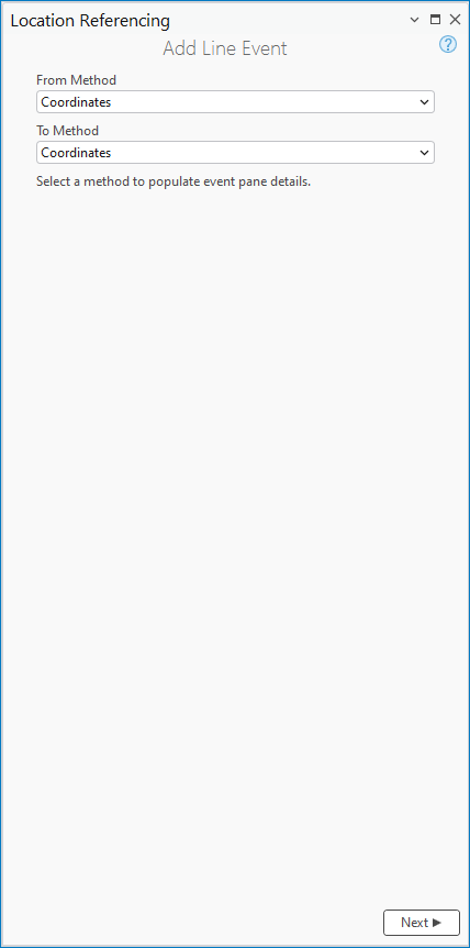

  1. Open the map in ArcGIS Pro and zoom to the location where you want to add the line event.
  2. On the Location Referencing tab, in the Events group, click Add > Line Event .
    The Add Line Event pane appears with the default Route and Measure value for From Method and To Method.
  3. Click the From Method drop-down arrow and choose Coordinates.
  4. Click the To Method drop-down arrow and choose Coordinates.
    Using the Coordinates method, the measure location is based on geographic coordinates.
    Add Line Event pane
