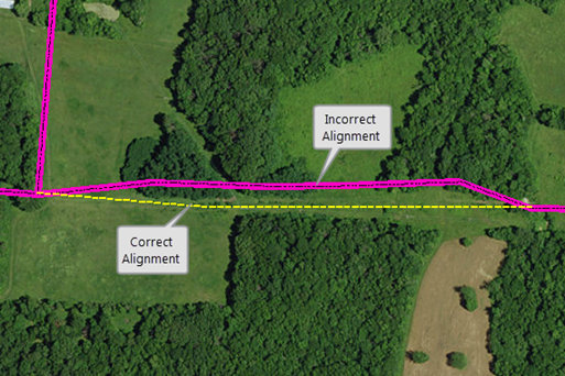

You can update route geometry based on aerial imagery, as-built drawings, or input from field data collectors without changing measures by making direct modifications to the centerline. This process is known as cartographic realignment. ArcGIS Pipeline Referencing allows you to change the shape of centerlines and preserve the calibration of the underlying routes as they existed before the cartographic realignment.

  2. Zoom in to the location of the alignment change.
    Note:
    The centerline feature for cartographic realignment of the route must exist in the centerline feature class before the realignment.
    Locating the route to be realigned

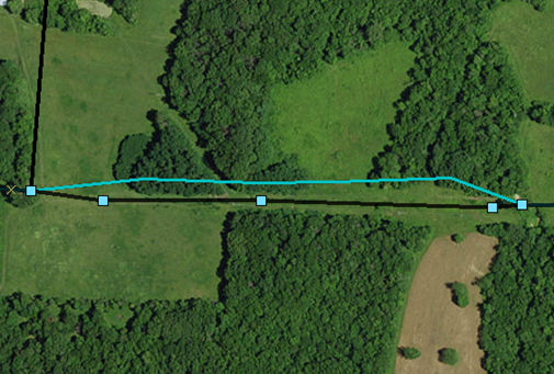

  5. Select the centerline feature in the map for editing.
  6. Edit the centerline's vertices as necessary.
    You can edit feature vertices and modify centerline segments using the Edit Vertices tool.
    Moving vertices and segments
  7. After editing the vertices to match the proposed alignment of the route, right-click anywhere on the map, and click Finish .
    The route is cartographically realigned.
