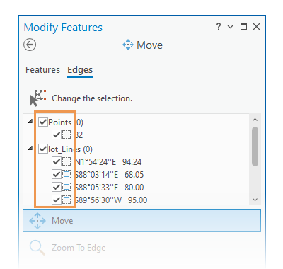

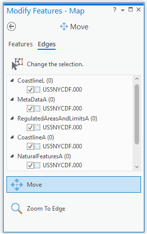

Click Select edge or node
and click the edge you want to edit.
In the selection view, review the check boxes for the selected edges and their origin layers.
To temporarily disable editing for a layer or an edge and keep them in the selection set, uncheck the corresponding check box.
To turn a selection on or off, click the select box. Alternatively, right-click a selected item and click Unselect
or Only Select This

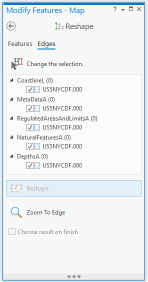

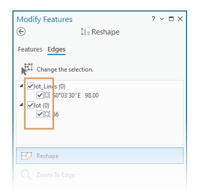

Click Select one or more edges
and click the edge you want to reshape.The selected edges appear in the selection view organized by layer and the pointer changes to the draw cursor.
The selection appears in the pane and is highlighted in the map. The editing toolbar appears with construction tools.
or Only Select This
