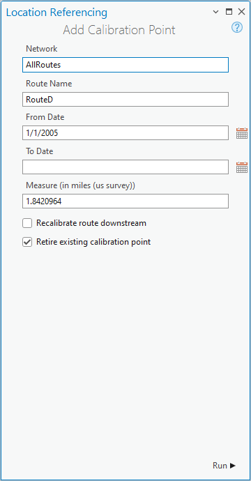

  1. On the Location Referencing tab, in the Calibration Points group, click Add .
  2. On the map, click a location on the route where you want to add a calibration point.
    The Add Calibration Point pane appears with the Network, Route ID, From Date, To Date, and Measure values automatically populated with information from the selected route on the map.
  3. Optionally, change the From Date and To Date values to specify when the calibration is applied to the route.
  4. Optionally, change the value in the Measure text box.
  5. Optionally, check the Recalibrate route downstream check box to recalibrate downstream calibration points along the route.
    • Checking the box applies recalibration to downstream calibration points along the route. For example, the existing calibration measure at the location where the calibration point is being added is 9, and the next downstream calibration point at the end of the route has a measure of 15. If the measure is changed to 10 and Recalibrate downstream is checked, a value of 1 is added to the downstream calibration point measure that changes to 16.
    • Leaving the box unchecked results in no recalibration for the next downstream calibration point along the route. Using the example above, changing the measure from 9 to 10 but not checking the Recalibrate downstream check box results in the downstream calibration point maintaining a measure of 15.
  6. Optionally, check the Retire existing calibration point check box to retire an existing calibration point at the click location.
    Note:
    When this check box is checked, the existing calibration point retires and is replaced by the calibration point being added at the specified date.
  7. Click Run.
    The calibration point appears on the map at the selected location.
