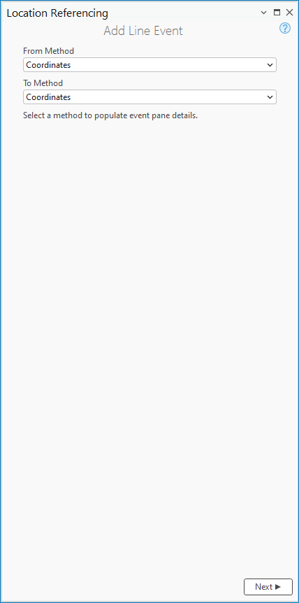

  2. On the Location Referencing tab, in the Events group, click Add > Line Event .
    The Add Line Event pane appears with the default Route and Measure value for From Method and To Method.
  3. Click the From Method drop-down arrow and choose Coordinates.
  4. Click the To Method drop-down arrow and choose Coordinates.
    Using the Coordinates method, the measure location is based on geographic coordinates.
    Add Line Event pane
    Tip:
    You can use a combination of any of the methods to locate the start measure and end measure values. For example, you can use Route and Measure for the start measure value, and use Coordinates to define the end location on the map.
    The methods you choose appear in the from and to section labels. For example, From: Route and Measure and To: Coordinates appear if the start method is Route and Measure and the end method is Coordinates.
  5. Click Next.

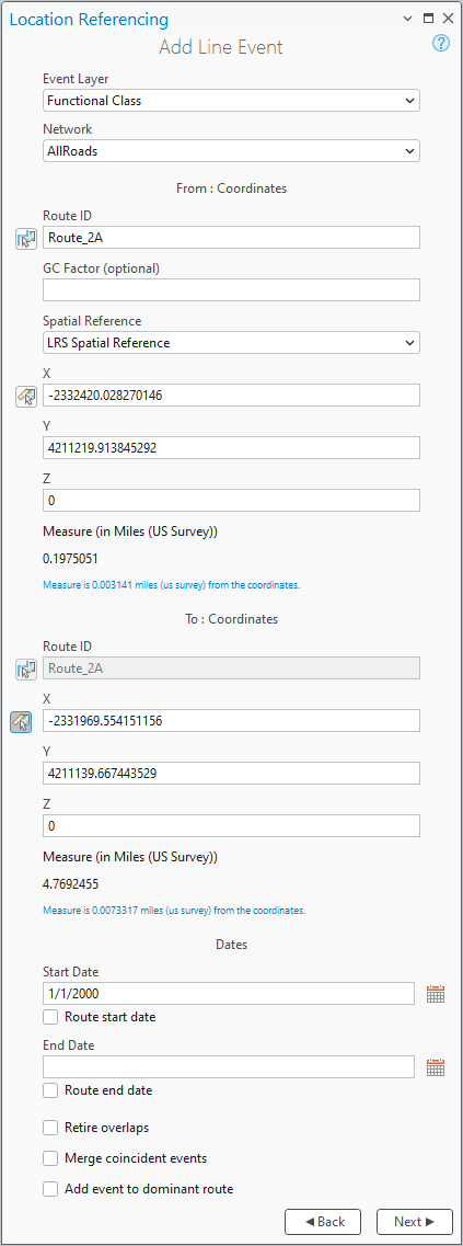

    The Event Layer and Network options and the From: Coordinates and To: Coordinates sections appear in the Add Line Event pane.
  6. Click the Event Layer drop-down arrow and choose the event layer where the events will be added.
    The parent LRS Network is populated based on the Event Layer value.
  7. Specify the route in the From: Coordinates section by doing one of the following:
    • Provide the route ID in the Route ID text box.
    • Click Choose route from map and click the route on the map.
    The specified route is highlighted in light blue.
    Note:
    If a message appears that is related to acquiring locks, the need to reconcile, or not being able to acquire locks, ArcGIS Roads and Highways conflict prevention is enabled.
  8. Optionally, in the From: Coordinates section, provide a geographic coordinate factor value in the GC Factor text box.
  9. In the From: Coordinates section, click the Spatial Reference drop-down arrow and choose a spatial reference:
    • LRS Spatial Reference—The spatial reference of the LRS network
    • Web Map Spatial Reference—The spatial reference of the basemap
    • GCS_WGS_1984—A geographic spatial reference using degree decimals as units
    Note:
    Choosing GCS_WGS_1984 provides Longitude, Latitude, and Height options rather than X, Y, and Z options.
  10. In the From: Coordinates section, provide coordinate values for X, Y, and optionally, Z, for the start location.
    A green square is placed at the specified coordinate on the map for the start location.
    A green dot appears on the route at the location nearest to the green square. This is the location of the start measure value of the event.
    Tip:
    Click Choose measure from map and click the location on the map.
    The route measure closest to the original coordinates is selected, and its distance from the route is displayed.
  11. In the To: Coordinates section, provide coordinate values for X, Y, and optionally, Z, for the end location.
    A red square is placed at the specified coordinate on the map for the end location.
    A red dot appears at the measure on the route to which the coordinate values correspond. This is the location of the end measure value for the event.
    Tip:
  12. Specify the date that defines the start date of the event by doing one of the following:
    • Provide the start date in the Start Date text box.
    • Click Calendar and choose the start date.
    • Check the Route start date check box.
    Note:
    The start date cannot be before the start date of the selected route.
    The start date default value is the current date, but you can specify a different date.
  13. Optionally, specify the date that defines the end date of the event by doing one of the following:
    • Provide the end date in the End Date text box.
    • Click Calendar , and choose the end date.
    • Check the Route end date check box.
    If no end date is provided, the event remains valid from the route start date and into the future.
    Add Line Event pane
  14. Choose a data validation option to prevent erroneous input while characterizing a route with line events as follows:
    • Retire overlaps—The measure, start date, and end date of existing events are adjusted to prevent overlaps with respect to time and measure values once the new line event or events are created.
      Learn more about retiring overlaps
      Retire overlaps behavior simple scenario
    • Merge coincident events—When all attribute values for a new event are exactly the same as an existing event, and if the new event is adjacent to or overlapping an existing event in terms of its measure values, and its time slices are coincident or overlapping, the new event is merged with the existing event and the measure range is expanded accordingly.
      Learn more about merging coincident events
      Merge coincident events simple scenario

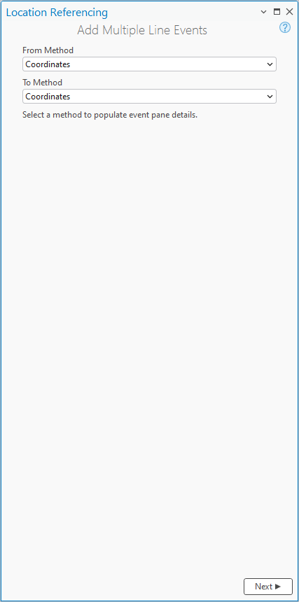

  2. On the Location Referencing tab, in the Events group, click Add > Multiple Line Events .
    The Add Multiple Line Events pane appears with the default Route and Measure value for From Method and To Method.
    Add Multiple Line Events pane with Coordinates method
    Tip:
    You can use a combination of any of the methods to locate the start measure and end measure values. For example, you can use Route and Measure to choose the start measure value, and use Coordinates to define the end location on the map.
    The methods you choose appear in the from and to section labels. For example, From: Route and Measure and To: Coordinates appear if the chosen start method is Route and Measure and the chosen end method is Coordinates.
  5. Click Next.

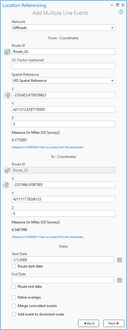

    The Network drop-down menu, and the From: Coordinates and To: Coordinates sections appear in the pane.
  6. Click the Network drop-down arrow and choose a network.
  7. In the From: Coordinates section, specify the route on which the events will be located by doing one of the following:
    • Provide the route ID on which the new event measure will be based in the Route ID text box.
    The line is highlighted in light blue.
    Note:
    If a message appears that is related to acquiring locks, the need to reconcile, or not being able to acquire locks, conflict prevention is enabled.
  9. In the From: Coordinates section, click the Spatial Reference drop-down arrow, and choose a spatial reference as follows:
  10. In the From: Coordinates section, provide coordinate values for X, Y, and optionally, Z, for the starting location.
    A green square is placed at the specified coordinate on the map for the starting location.
    A green dot appears on the route at the location nearest to the green square. This is the location of the starting measure of the event.
    Tip:
    Click Choose measure from map , and click the location on the route.
    Tip:
  12. Specify the date that defines the start date of the events by doing one of the following:
    Note:
    The start date default value is today's date, but you can specify a different date.
  13. Optionally, specify the date that defines the end date of the events by doing one of the following:
    The end date is optional. If no end date is provided, the event remains valid from the event start date into the future.

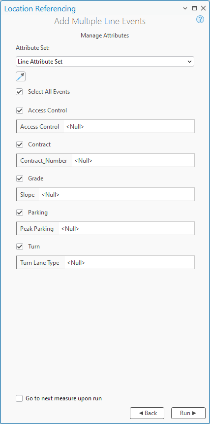

  16. Optionally, click the Attribute Set drop-down arrow, and choose an attribute set.
    The Attribute Set drop-down menu includes other attribute sets if configured.
  17. Provide attribute information for the new events.
    Add Multiple Line Events pane with Manage Attributes section
    Note:
    Click Copy attribute values by selecting event on the map and click an existing line event belonging to the same event layer on the map to copy event attributes from that event.
  18. Click Run.
