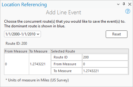

Route 200 has a start date of 1/1/2000, and route 100 and route 300 both have a start date of 1/1/2010. As a result, if the selected start date of the event is 1/1/2000, there are two route time ranges as follows:
  • 1/1/2000 to 1/1/2010, when only route 200 existed.
    Add Line Event pane showing the 1/1/2000 to 1/1/2010 time range

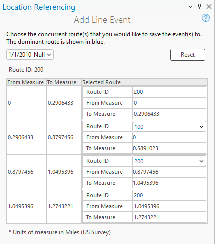

  • 1/1/2010 to Null, when all three routes existed.
    Add Line Event pane showing the 1/1/2010 to Null time range

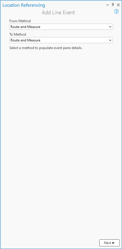

  2. Click the Location Referencing tab, and in the Events group, click Add and click Line Event .
    The Add Line Event pane appears with the Route and Measure default value for the From Method and To Method options.
    Using the Route and Measure method, the measure location is based on the measure values from the selected route.
    Add Line Event pane

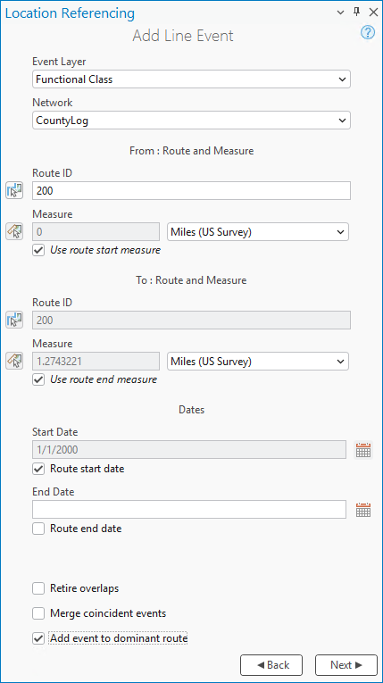

  4. Click the Event Layer drop-down arrow, and choose a line event layer.
    The Network layer is automatically populated once the event layer is chosen. The network serves as the source linear referencing method (LRM) to define the input measures for the event.
    The network is an LRS Network published as a layer in the feature service.
  5. Click Choose route from map and select the route on the map to populate the Route ID value.
    Note:
    If a message regarding acquiring locks or reconciling appears, conflict prevention is enabled.
  6. In the From: Route and Measure section, specify the start measure by doing one of the following to populate the Measure text box:
    • Click Choose measure from map and select the start measure value along the route on the map.
    • Check the Route start date check box.
    • Provide the start measure value in the Measure text box.
    A green point appears at the selected location on the map.
  7. Optionally, in the To: Route and Measure section, specify the end measure for the new line event along the route by doing one of the following to populate the Measure text box:
    • Click Choose measure from map and select the end measure value along the route on the map.
    • Check the Use route end measure check box.
    • Provide the end measure value in the Measure text box.
    A red point appears at the selected location on the map. The event will be created between the green and red points.
  8. Specify the start date of the event by doing one of the following:
    • Click Calendar and choose the start date.
    • Provide the start date in the Start Date text box.
    • Double-click in the Start Date text box to use the current date.
    The start date default value is the current date, but you can choose a different date using the date picker.
  9. Optionally, specify the end date of the event by doing one of the following:
    • Click Calendar and choose the end date.
    • Provide the end date in the End Date text box.
    • Check the Route end date check box.
    • Double-click in the End Date text box to use the current date.
    If no end date is provided, the event remains valid from the route start date into the future.
  10. Choose a data validation option to prevent erroneous input while characterizing a route with line events:
    • Retire overlaps—The measure, start date, and end date of existing events are adjusted to prevent overlaps with respect to time and measure values once the new line event or events are created.
      Retire overlaps simple scenario
      Learn more about retiring overlaps
    • Merge coincident events—When all attribute values for a new event are exactly the same as an existing event, and if the new event is adjacent to or overlapping an existing event in terms of its measure values and its time slices are coincident or overlapping, the new event is merged with the existing event and the measure range is expanded accordingly.
      Merge coincident events simple scenario
      Learn more about merging coincident events
  11. Check the Add event to dominant route check box.

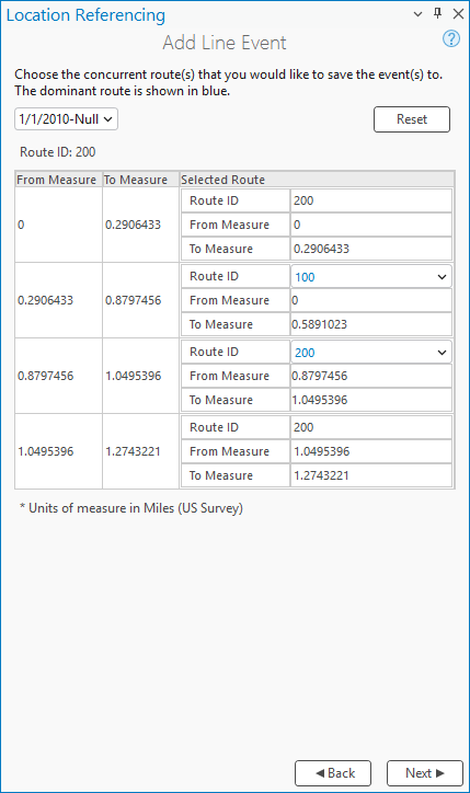

    The route dominance table appears in the Add Line Event pane.
    Route dominance table in the Add Line Event pane
    The From Measure and To Measure columns show the values for each section of the chosen route from the previous pane. The From Measure and To Measure boxes under Route ID show the value for each dominant route where the events are added.
    A route ID in black text without a drop-down arrow signifies that there was a single route in that section. A route ID in blue text with a drop-down arrow signifies that there are concurrent routes in that section, and the route in blue text is selected automatically based on the route dominance rules. You can manually select any other route using the drop-down arrow.
    If you checked the Merge coincident events check box, the records in sections 3 and 4 are merged because they have the same route ID.

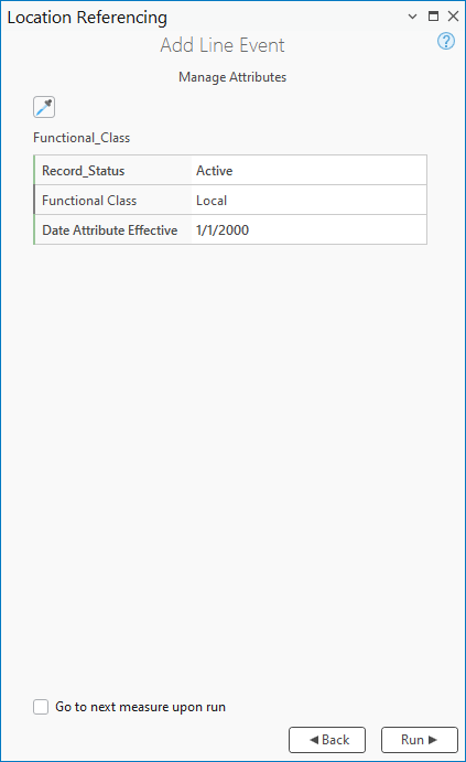

    The attributes for the chosen event layer appear under Manage Attributes.
    Note:
    Enable the Go to next measure upon run option to start your next edit at the end measure location of the previous edit. The To Method value and its populated information from the previous edit will carry over to the next edit as the From Method value and its populated information.
    For example, if you use a From Method value of Location Offset and a To Method value of Coordinates to add a line event, enabling the Go to next measure upon run option will start your next edit with From Method and To Method values of Coordinates with the coordinates information from the previous edit in the From: Coordinates section.
  14. Provide attribute value information for the event.
    Manage Attributes page in the Add Line Event pane
    Note:
    Click Copy attribute values by selecting event on the map and click an existing line event belonging to the same event layer on the map to copy event attributes from that event.
    Note:
    Coded value domains, range domains, subtypes, contingent values, and attribute rules are supported when configured for a field.
  15. Click Run.
