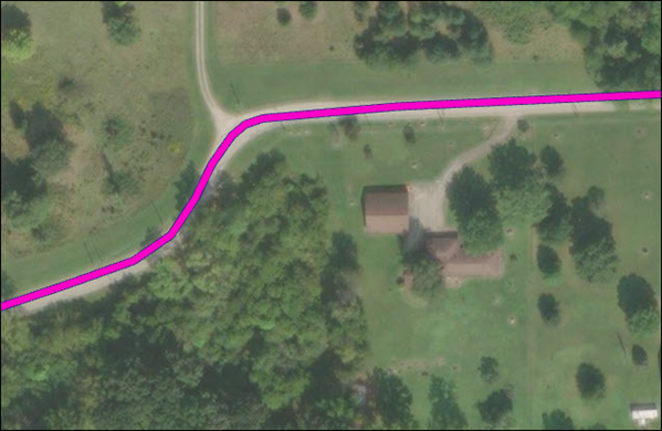

    Locating the route to be realigned
    The numbers in the image above correspond to the numbers in the following table:
    Component
    Description
    Correct alignment
    Incorrect alignment
