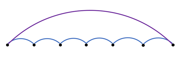

Many Roads and Highways operations are spatial in nature. These include route editing tools like Realign and operations such as measure interpolation to populate M values on polylines. For data in a GCS, the spacing of the vertices along with the tolerance of the feature class can impact the level of accuracy in the calculations. Once the distance between two vertices reaches a specific threshold, the level of accuracy in calculations decreases. In the image below, two polylines in a geographic coordinate system are shown. The polyline in blue has multiple vertices that make up the polyline, while the polyline in purple has only two vertices total. The blue polyline has smaller segments, which results in smaller arcs. Compared to the single large arc on the purple polyline, the calculations on the blue polyline would be more accurate.
This diagram depicts a polyline with two vertices and a polyline with multiple vertices.

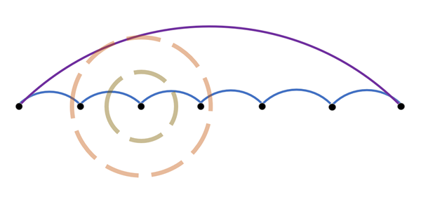

Additionally, the x,y and z-tolerance of the feature class contributes to the level of accuracy in Roads and Highways spatial operations. The tolerance is used as a search radius. The larger the tolerance, the larger the search radius when looking for polyline segments or arcs. The image below shows two polylines with two different tolerance values overlaid. Notice the larger tolerance radius in orange not only intersects with the blue polyline but also the purple polyline. As linear referenced data is modeled and maintained, it’s important to keep the density of vertices and the x,y and z-tolerances in mind to ensure measures are accurate.
This diagram depicts two polylines with different tolerance values.
