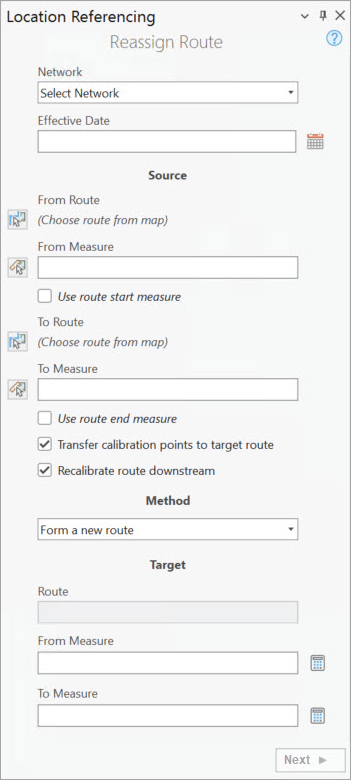

  3. On the Location Referencing tab, in the Routes group, click Reassign .
    The Reassign Route pane appears.
  4. Click the Network drop-down arrow and choose the network in which the route reassignment will take place.

  6. In the Source section, click the Choose route from map button and click the route on the map to populate From Route Name.

  7. Provide a starting measure value for the route by doing one of the following:
    • Provide a value in the From Measure text box.
    • Click the Choose measure from map button and click a measure on the map.
    • Check the Use route start measure check box.
    A green dot is placed at the location. The reassignment starts from this location.
  8. Click the Choose route from map button and click the route on the map to populate To Route Name.
  9. Provide an ending measure value by doing one of the following:
    • Provide an ending measure value in the To Measure text box.
    • Click the Choose measure from map button , and click a measure on the map.
    • Check the Use route end measure check box.
    A red dot is placed at the location. The reassignment takes place on the routes or the portions of routes that exist between the green and red dots. The routes that are intersected by the reassignment portion are retired.
  10. Choose whether to recalibrate the remainder of the reassigned route downstream of the reassigned portion.
    • Check the Recalibrate route downstream check box to recalibrate the remainder of the reassigned route downstream of the reassigned portion.
    • Uncheck the Recalibrate route downstream check box if you do not want to recalibrate the remainder of the reassigned route downstream of the reassigned portion.
  11. Choose whether to transfer the source calibration points to the target route using the Transfer calibration points to the target route check box.
    The Transfer calibration points to the target route check box is checked by default and is the preferred method to maintain established measures between points.

  12. Choose the Form a new route method for reassignment:
    Form a new route selection
  13. In the Target section, in the Route Name text box, provide a new route name to reassign to a new route.
  14. Provide a starting measure value for the target route reassignment location by doing one of the following:
    • Provide a starting measure value in the From Measure text box.
    • Click the Recalculate From Measure button . The starting measure value is calculated as the source measure length minus the ending measure value.

  15. Provide the ending measure value of the target route reassignment location by doing one of the following:
    • Click the Recalculate To Measure button . The ending measure value is calculated as the source measure length minus the starting measure value.
  16. Click Next.
