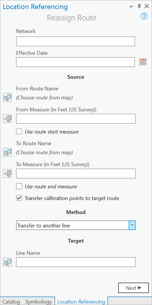

  12. Choose Transfer to another line as the method for reassignment:
    Reassign Route pane with Transfer to another line method specified
  13. In the Target section, click the Choose line from map button and select the target line on the map.
    The source will be transferred to this line.
    The name of the line you selected on the map populates the Line Name text box and the source routes will be transferred to this line.

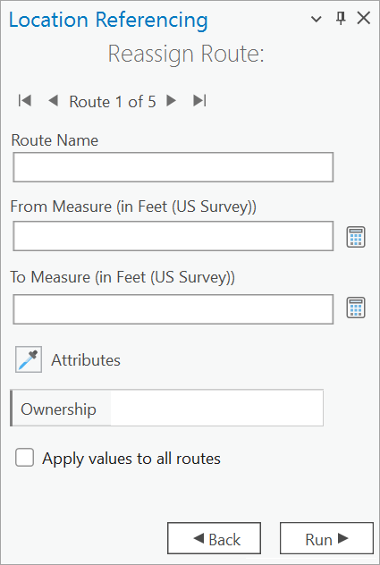

    The Reassign Route pane appears.
    The Route Name, From Measure, and To Measure values for each source route are populated. You can update them in the following steps.
    Reassign Route pane
  16. Optionally, provide another route name.
  17. Optionally, provide a From Measure value for the target route reassignment location by doing one of the following:
    • Provide a starting measure value in the From Measure text box.
    • Click the Recalculate From Measure button . The starting measure value is calculated as the source measure length minus the ending measure value.
    Note:
    For the line network, the measures can be entered as station values in 00+00.00 or 00+00.000 format.
  18. Optionally, provide a To Measure value for the target route reassignment location by doing one of the following:
    • Provide an ending measure value in the To Measure text box.
    • Click the Recalculate To Measure button . The ending measure value is calculated as the source measure length minus the starting measure value.
    If the network has attribute fields other than the system-defined fields, you can either transfer the existing values of the source route or provide new values in the Reassign Route pane. The existing values of the source route are populated by default.
    If the reassignment spans multiple routes, the values from the first starting value of the route will be populated by default.
    This attribute section also supports domains, subtypes, contingent values, and attribute rules.
    Note:
    The field alias, not the field name, appears in the Reassign Route pane.
