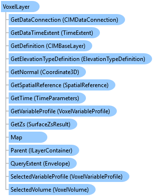

    Object Model
    VoxelLayer ClassCIMDataConnection ClassTimeExtent ClassCIMBaseLayer ClassElevationTypeDefinition ClassCoordinate3D StructureSpatialReference ClassTimeParameters ClassVoxelVariableProfile ClassSurfaceZsResult ClassMap ClassILayerContainer InterfaceEnvelope ClassVoxelVariableProfile ClassVoxelVolume Class
