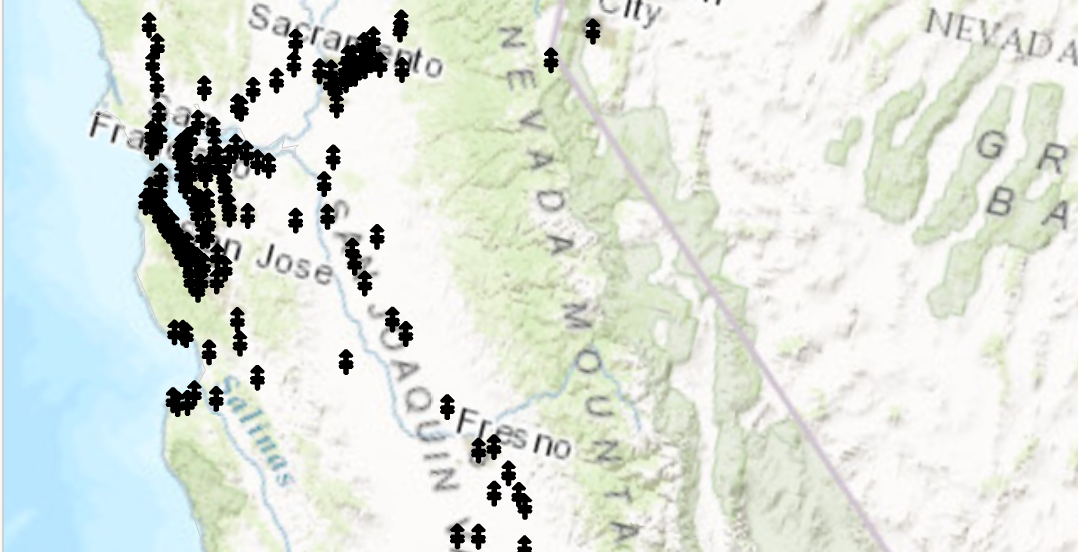

    Point Symbol from a font
    /// <summary>
    /// Create a point symbol from a character in a font file
    /// ![PointSymbolFont](https://ArcGIS.github.io/arcgis-pro-sdk/images/Symbology/point-marker.png)
    /// </summary>
      //creating the marker from the Font selected
      //Note: Run withing QueuedTask
      var cimMarker = SymbolFactory.Instance.ConstructMarker(47, "Wingdings 3", "Regular", 12);
      CIMPointSymbol fontPointSymbol = SymbolFactory.Instance.ConstructPointSymbol(cimMarker);
      //To apply the symbol to a point feature layer
      //var renderer = pointLayer.GetRenderer() as CIMSimpleRenderer;
      //renderer.Symbol = fontPointSymbol.MakeSymbolReference();
      //pointLayer.SetRenderer(renderer);
