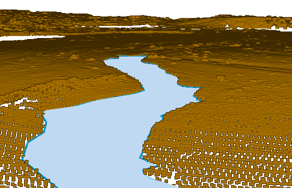

Creates height adjusted breaklines from 3D polygons representing river banks.
Illustration
Enforce River Monotonicity tool illustration
